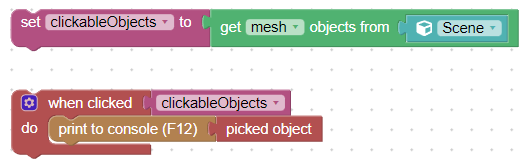

    #64161
    Scene and other empty objects are not clickable. Only objects with geometry (meshes) are clickable.
