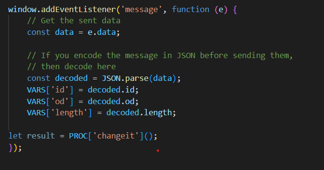

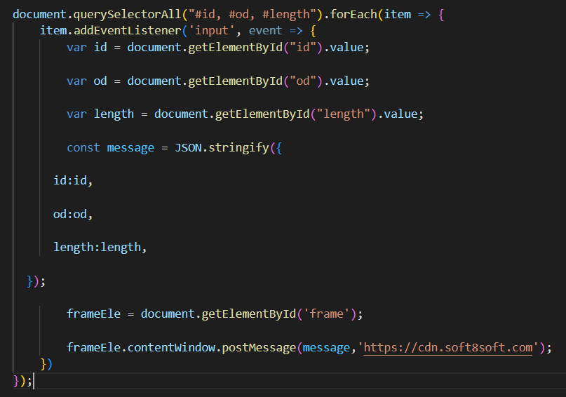

I am creating an application that uses shape keys and set morph factor to manipulate a simple 3d model. I am sending data to the verge 3d iframe via postMessage.
The input fields in the parent document have an “input” eventlistener, so any time the input is changed, the data is sent to the iframe. The data is sent via JSON (stringify) and then parsed once it is received in the iframe.
My puzzle listens for a message event, and then sets VARS[”] for each of the 3 shape keys, then calls a protocol which sets the morph factors to the created variables.
The problem is, whenever I change the input, my object disappears and I can’t figure out why.
At one point I had it working, so I know it is possible but I can’t figure out why it no longer functions!
Any help would be greatly appreciated! Thank you.
I attached the code that sends the data to the iframe, as well as the code in my puzzle.Attachments:

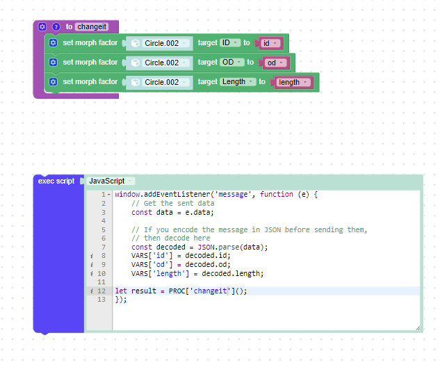

2022-10-02 at 8:46 pm #56314natecaspar
ParticipantHere’s a screenshot of the full puzzle with the changeit procedure.

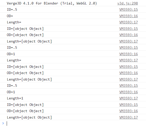

I know that the data is being received and properly parsed, as I can log each VARS upon being received by the iframe. Here’s a screenshot of the VARS being logged.
Thanks!
2022-10-02 at 8:52 pm #56317kdv
ParticipantID = [object Object]doesn’t bother you?Puzzles and JS coding. Fast and expensive.
2022-10-02 at 9:14 pm #56320natecaspar
ParticipantThanks so much for the help! I’ll try to implement that now. Not sure why the ID = [object Object] is returned as well as the VARS value…
2022-10-02 at 9:44 pm #56322kdv
ParticipantThe point is that a morph factor must be a numeric value. If an input value cannot be converted into a number it will kill your model.
