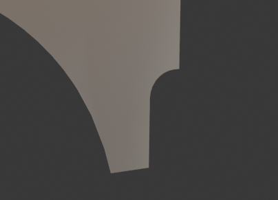

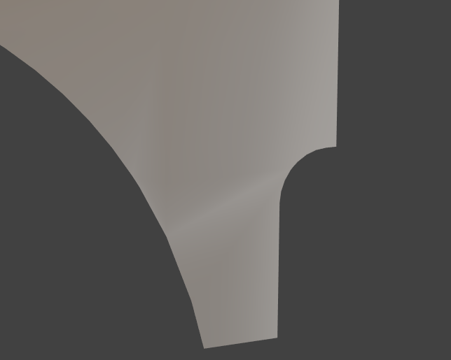

    image01 is in verge3d, image02 in blender.
    same camera, material and all.
    verge3d has this strange “z-shaped” reflection, which is not visible in blender.
    other spots are notably different, too.
    it could be some difference in normal interpolation, the falloff between verts seems more linear / abrupt in verge3d.
    or is there a different precision level used in v3d? high quality normals in blender are disabled.
    the differences are not huge, but since the imperfections are far less visible in blender, it is hard to adjust/fix them. most of them only become visible once exported.
    Edit: attached example blend file
    Edit2: also the normal interpolation seems to be different on the mirrored side.
    #34078
    It’s because of n-gons, if you’ll triangulate the model in Blender you will get the same quality, but the engine do this automatically before export because n-gons not supported. The only way to this this is to triangulate manually as you need to get the best effect.
    #34106
    thomasup
    true, that sure is a contributing factor.

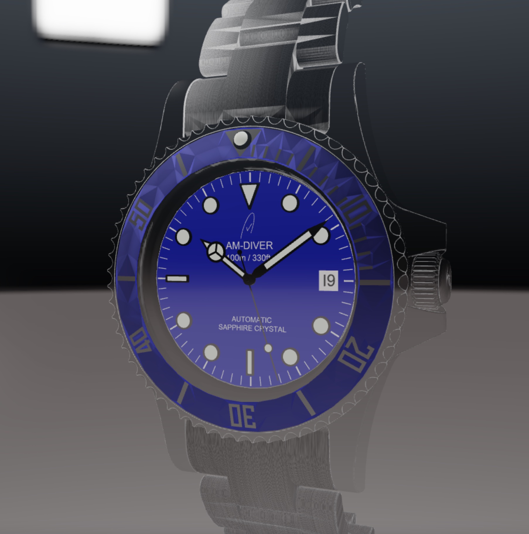

    I see significantly worse picture in browser (Chrome on MAC) in comparison with the one in viewport (3.1.2): all metals are kind of transparent and glass is not. Comparison below is without glass.
    Tnanks for your help.

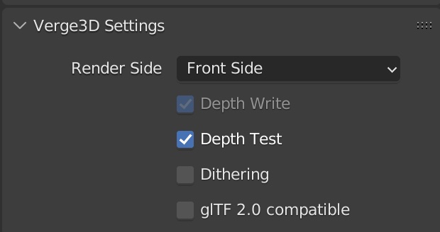

    #56167
    Check the blend type of the material and seth test and depth write checkboxes.
    #56175

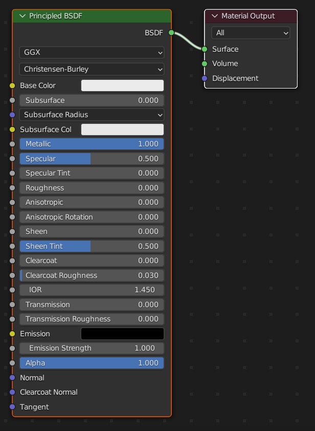

    v3dbeginner
    Thanks a lot for the quick response!
    I am using default settings and the simplest materials without mixtures and textures, as in your swiss-army-knife example.
    #56193
    can you share the blend file?
    #56195
    v3dbeginner
    sure, how to do it best? Since I am a beginner, it is rather bulky (34 Mb).
    #56199
    you can upload it on some file sharing service and leave the link here.
    #56302
    v3dbeginner
    here we go:
    https://drive.google.com/file/d/15-_q7MBeTsh12K3cmIFSa_Xtzd2Y6wV-/view?usp=sharing
    Please, remove the link after you download the file or let me know so I can remove the file.
    Thank you!
    I am going to order the freelance license as soon as I get the reasonable quality in the browser using the trial version.

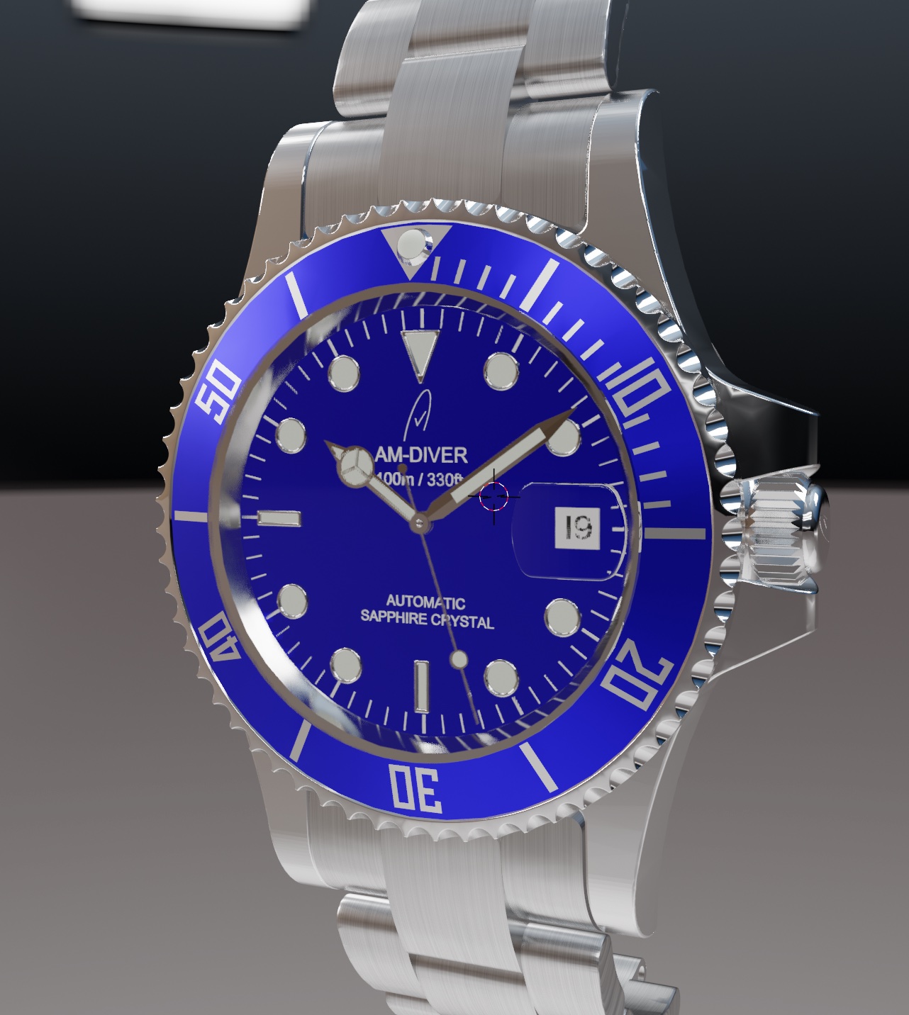

    #56335
    You have a scale on the camera, reset it to 1,1,1 and all will be ok.
    #56338
    v3dbeginner
    Thank you, that helped! I guess, the glass remains still not transparent.
