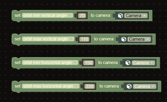

    The Puzzles work. The issue is the Camera (only one in the Scene) snaps instead of smoothly zooming in and out with the MouseWheel. Anyone know why? Perhaps this is a defect? Try adding a Cube with a texture. Then left-click and drag to rotate and angle the cube in all directions. Using Orbit option with the new Camera Puzzles, that works.
    Then zoom in and out on the object with the MouseWheel. Notice how it’s not smooth? It snaps the camera in increments. No tweening.

    It’s very straight forward. All you need to do is add these 4 puzzles (I joined them as you can see in the image https://www.soft8soft.com/wp-content/uploads/2021/12/verge3D-2.9-Preview-2-MouseWheel-Zoom-Not-Smooth-Now.png). Then add a cube to the scene (Blender defaults to that view even). Run The Verge3D project so the tab with Localhost is showing. Mousewheel zoom in and out. Is it smooth mostly or does it jump on each MouseWheel movement step?

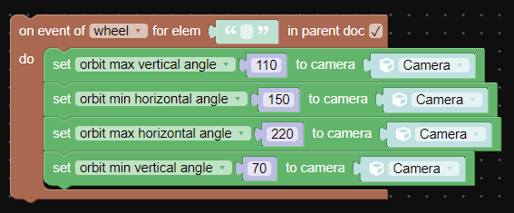

    Just wrap the 4 Set Puzzles (picture above and updated image here) in an on event of wheel for element “” in parent doc (checked). And now instead of what seems every frame, the zoom happens on the MouseWheel clicks (up and down).
