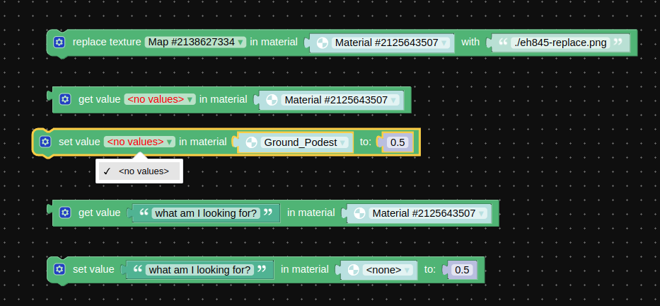

    Can I use puzzles to completely modify or even create new material’s? I know I can change the texture on the map of exiting materials and change the RGB values, if they already exist in the material. But I would love to have the freedom of creating and modifying all available options of a material (metallic, roughness, albedo etc.). Somehow like playing around with an modify the variables of a material in the babylon playground.
    There is a get value and set value puzzle in the material category, but when I select an existing material, the list of available values keeps empty, and I don’t know what exact name of values I can use. Is there a reference where I can look it up maybe?

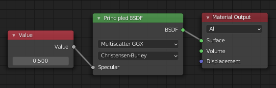

    you should add a numeric value node in the material first

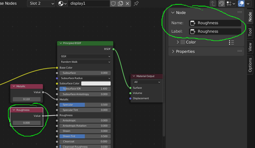

    Thank you for your answer. Indeed, it works like you described it.
    I need to change the value-nodes name, so I can find the right value in puzzles.

    So I need to set a value-node in the node-system of my 3D-software to be able to access it in puzzles?
    What else do you want to change? You can change textures, you can change values in BSDF nodes, you can mix shaders using the Value node as a factor. Yes, you have to prepare the material first to have an ability to tune it…

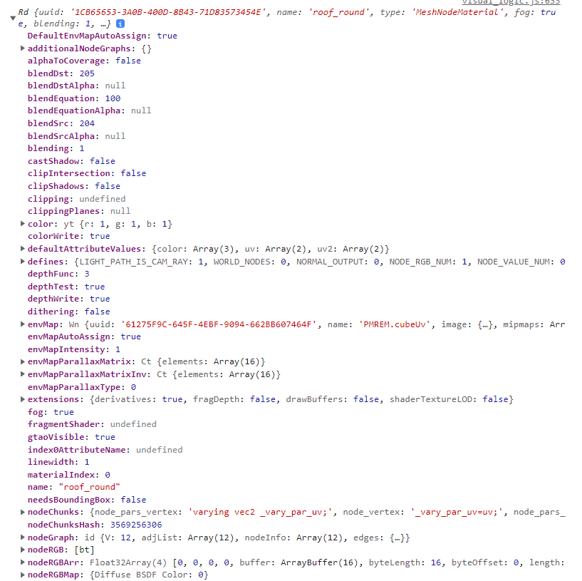

    Well, you can change some parameters via coding…
    Print to the browser console some material to see available parameters…

    Thank you very much for your feedback. I was analyzing some materials in the console.log and now I understand that there is much more going on under the hood than I was expecting. :wacko:

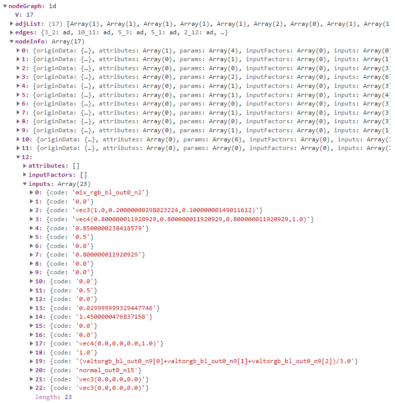

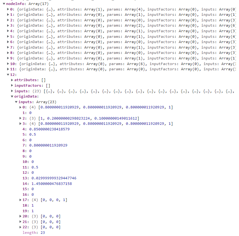

    In example changing the metallic and roughness factors. So I thought I could do it in Puzzles,but that seems to be not the way to go.
    In fact, you have an access to those parameters like the metallic and roughness factors, but they are hidden really deep )))
    this is the Blender’s Principled BSDF. the values above can be changed via coding, but I don’t see any visual effect )))
    reading Roughness, for example…
    console.log(mat.nodeGraph.nodeInfo[12].inputs[7].code);
    console.log(mat.nodeGraph.nodeInfo[12].originData.inputs[7]);
