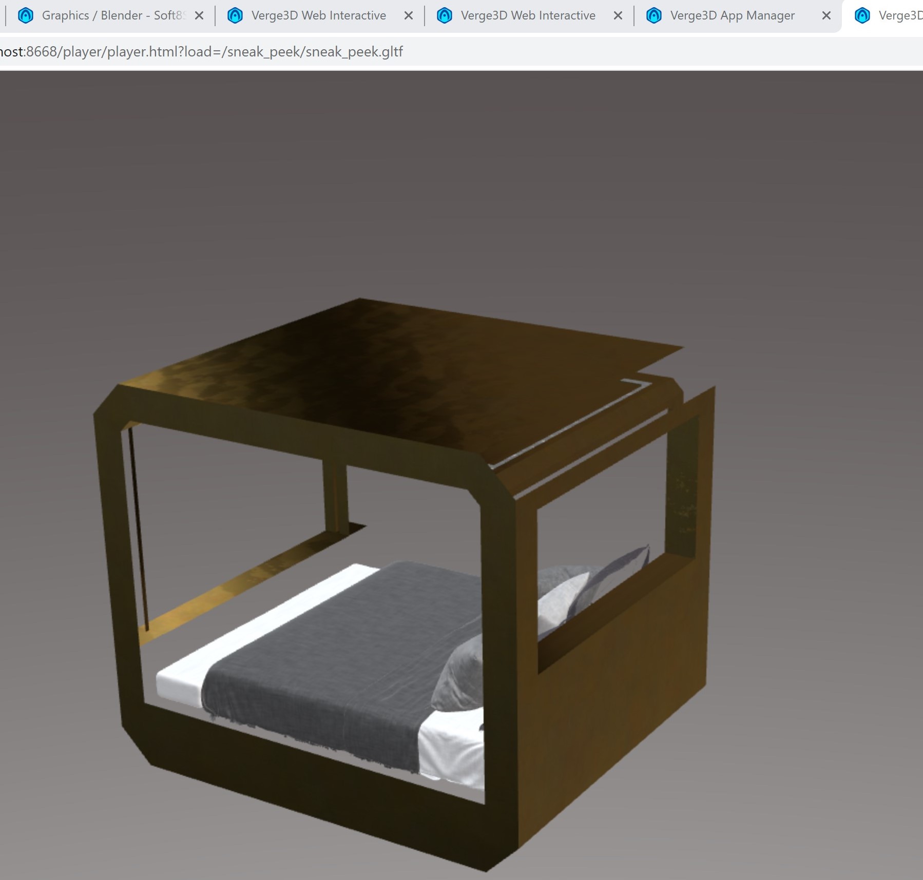

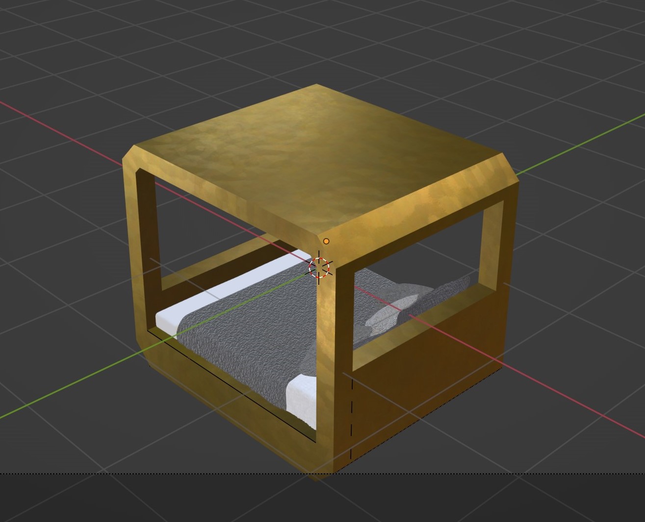

    I’m beginner with blender and Verge3D, I followed to video tutorials to create a web configurator.
    I have an issue when I generate the seakpeek.gtlf, some parts of my model are missing. I attached pictures of the issue.
    Do you have any ideas what is the problem ?
    Thanks a lot for your help
    HG
    #58937
    flipped normals. you see the back side of planes. You can use a double-sided material to ignore flipped normals…

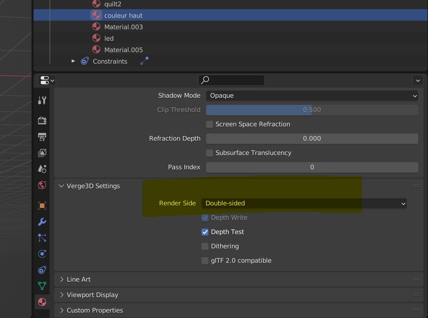

    Thanks for your help, I fixed the problem :good:
    I attach an image for the option to select for noobs like me :)
    #58947
    You’d better flip wrong normals anyway ))) It’s more correct approach…
