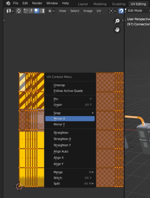

    Hello! I’m wondering if it’s possible to mirror UV Map with puzzles?

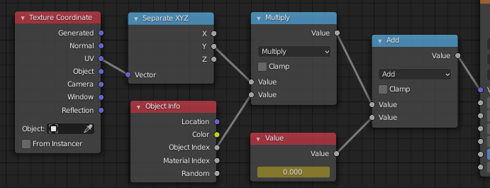

    I’ve got a nice material shader that animates along the path and I would like the user to be able to change the direction of the animation for the different objects with a button click. In Blender, mirroring the UVMap does the trick. Is there any way to do it with puzzles?
    Alternatively, is it possible to change the object’s pass index in Blender with a puzzle? That might work too with playing around with some Object Info nodes.

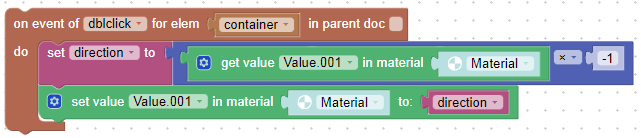

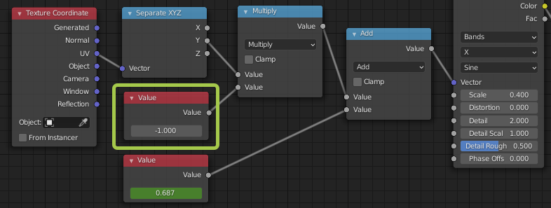

    there is no need to do it. you can change the flow direction this way
    and that value can be controlled in Verge3D
    https://v3d.net/iqo

    Mariusz
    Yes, but changing this main Value, changes the direction of the complete material for all the objects. And I would like to change the direction only for the selected objects, and preferably keep one material to do this (to reduce the number of shaders for performance reasons). Any idea how this can be done?

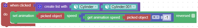

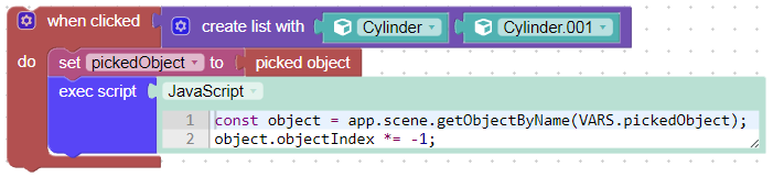

    #63726
    Something like this will work
    https://v3d.net/iqo

    Mariusz
    It works, thank you again! :yahoo:
    In my case, I used the object’s mesh Blender name in getObjectByName and used object.objectIndex = 1; and now it works like a charm.

    A little simplier way to get what you want. Works even better, without “jumps”.

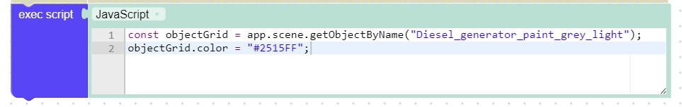

    Mariusz
    Thanks kdv!
    Another question about Javascript, maybe you will know the answer. Can we, in a similar way (with Javascript), change the Viewport display color? I’m trying with your code but it doesn’t work and Google didn’t help me find the right answer yet…

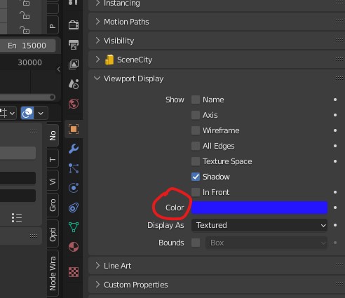

    Mariusz
    Viewport display Color it’s an object property in Blender. By using the material node “Object Info”, and the slot “Color” we can use one material for different objects and each of these objects can have its own color assigned.
    #63762
    objectGrid.objectColor = new v3d.Color('#2515FF');
    #63763
    Mariusz
    It works, thanks again! :good:
