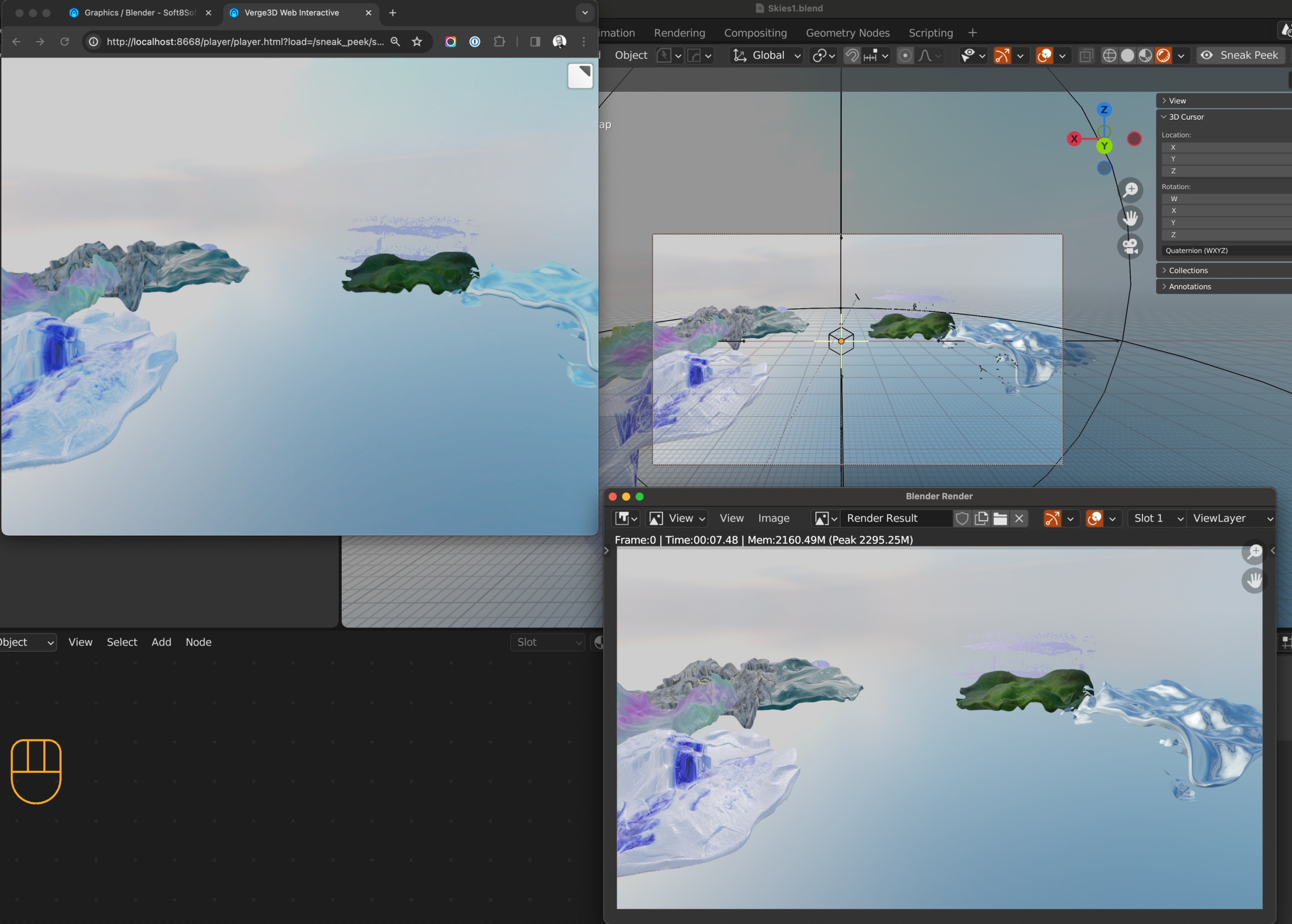

xeonCustomerOK..so if you do some basic diagnostics and delete the 12 Million poly object and delete your sphere you will notice your project loads in to v3D faster and all the materails show up as expected….nothing black.
You have a reflection map being created but it was taking into the effect the inside of a sphere that was casting shadows with normals the wrong way…etc…..just causing problems.
The results when rendered in Blender line up pretty nice with that inside V3D.
You should experiment with the World Environment Shader. This is like a giant environment sphere and will act as your light source for your scene.
With respect to your materials not showing up.. when inside v3d. I would guess its a puzzle related issue….post your project and we can quickly find out.
But optimize the project file before you post … please by removing that large 12M poly object and the 132Mb Texture.
