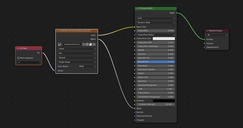

    that works for fonts & solid colored interface objects, but how do I do this for objects mapped with an alpha channel?
    Right now I have the attached setup for the textures with alpha channel.
    The problem is that I am dealing with a clients logo and need to have it display in the correct colors, so I can not just add emission as it would brighten the colors.

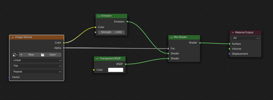

    #49573
    Use this setup.
