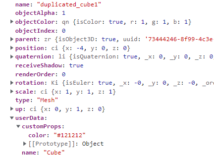

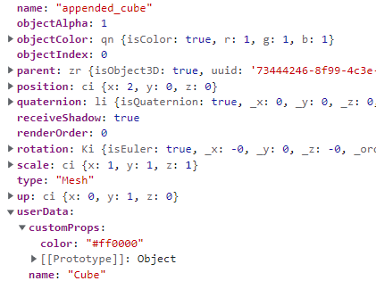

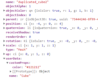

The “Userdata/CustomProps” dictionnary which is part of the Object3D javascript object IS changed when I manipulate my Object with puzzles, even if I do not explicitely tell my application to write the data in the object’s dictionnary.
In other words, in my Application, I create from scratch a custom dictionnary (addedObjectsDictionnary) where I import a blender created CustomProps dictionnary, name it with a new unique ID. This dictionnary is updated when I make modifications on my object (color, position, rotation, etc…), but for some reason, the “Userdata/CustomProps” dictionnary inside the 3D object is also changed!
And the reason why my objects where linked previously (I guess!) was that I did not make the “import customprops” step and simply duplicated my puzzle created dictionnary and asigned a new UID. But inside the 3D object they were still linked.
Here are two screenshots of the console log for one of my objects before and after a modification (obtained with getObjectByName, no other manipulation). And as I said, I never explicitely tell my application to write something in the Object3D object…

CustomerThe objects DO HAVE independant and unique names, as well as their materials. I was able to change the colors, positions, scale, etc… independently, but as soon as I wanted to WRITE these data in my dictionnary, these parameters are “synchronized” if I do not create a new set of customProps… I’ll try to make a simple demo of this particular behaviour, it should me much simplier…

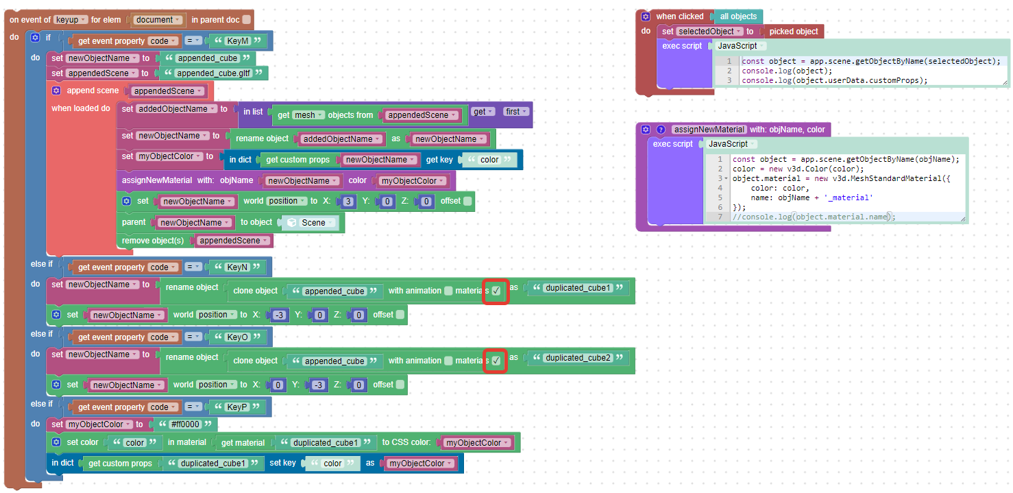

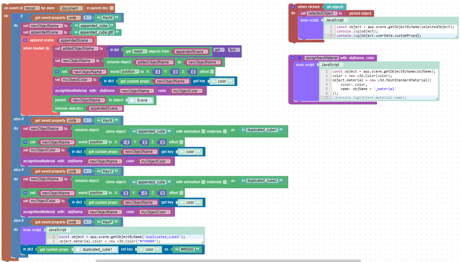

CustomerHere is a simple demo showing the behaviour I do not understand:
Clone demo
Several keyborad inputs will trigger the following steps:-
“M” will append a simple cube, add its custom properties (defined in blender) as a new entry in the addedObjectsDictionnary and give it a named material, and a color according to the imported property
“N” will duplicate and rename the first appended cube, move it and COPY the first cube’s key in the addedObjectsDictionnary, as a new key, named after the second cube: duplicate_cube1.
“O” will again duplicate the first cube, rename it duplicate_cube2, move it, and this time, re-import the custom properties to define the new key in addedObjectsDictionnary.
“P” will lastly change the color for duplicate_cube1, and store the new color in the dictionnary for that key.But you will see that in the dictionnary, the color has changed for both appended_cube AND duplicate_cube1! How is that possible??
A click on the object prints the Object3D javascript object in the console.2023-11-02 at 3:10 pm #68153kdv
Participantzip. puzzles.
No. I see that visually color changes for one cube but in custom props the new value appears only for the first appended cube. And I would say that’s not correct. Some mistake in your logic…
