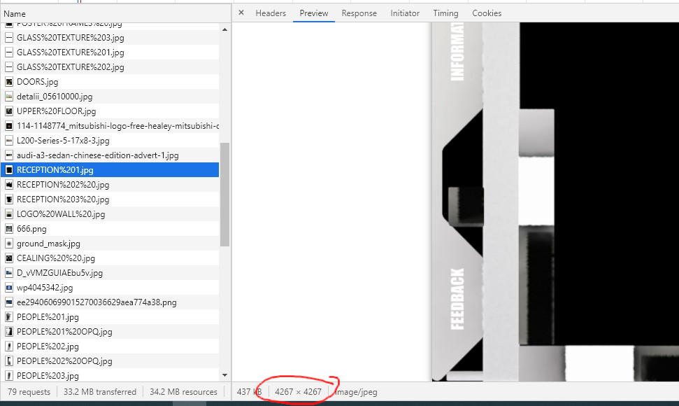

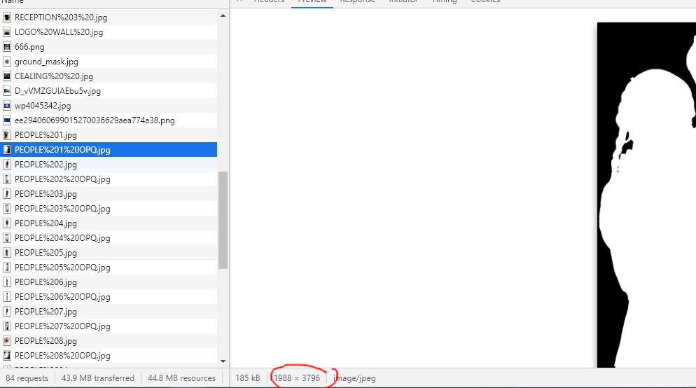

    Many of them more than 1k. For example this. (see pics below)
    You also have a lot of texture and even 1024×1024 is too much for them. Try to lower them to 256×256 and decrease amount of textures for the whole scene by combining them or reuse. Some of them also in png, better to convert them to jpg.
