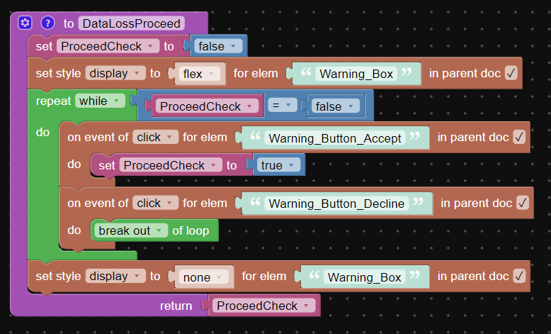

    #70925
    takeoutprism
    This block seems to be the culprit. Disabling it and reuploading to the webserver resolves the error.
    puzzles
    I’ll need to come up with a different method for essentially prompting “Are you sure?” before executing some puzzles.
    #70928
    Try removing the loop?
    #70929
    Your loop is a culprit. It’s useless and senseless and actually does nothing except adding the huge amount of event listeners.
    #70930
    takeoutprism
    I wanted to delay the return of the function until the user clicks on one of the buttons in the warning popup.
    #70931
    Your warning box is already a delay. Execute you puzzles on accept, do nothing on decline. No loops.
