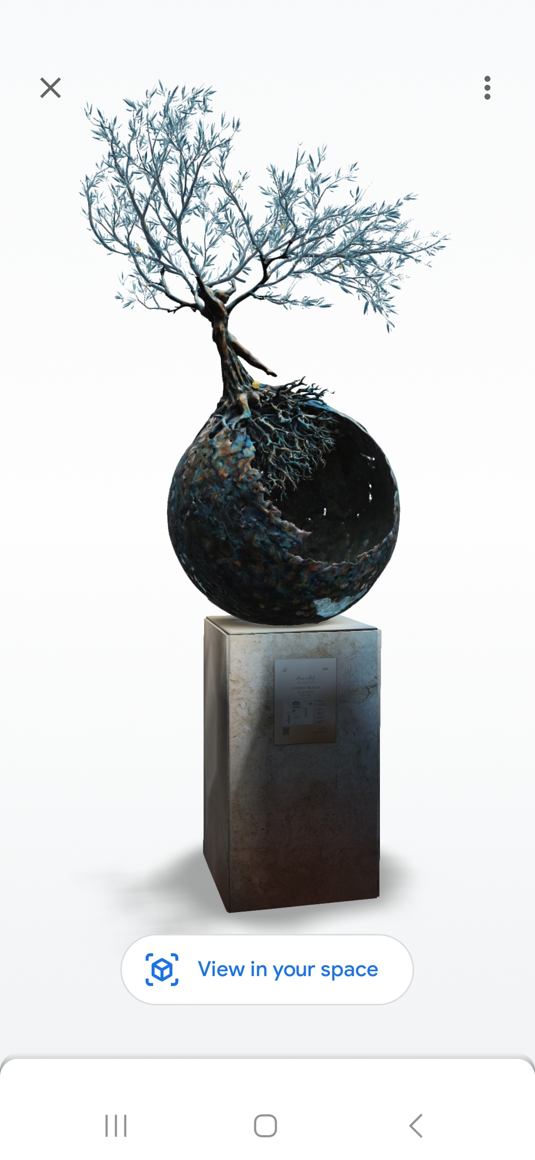

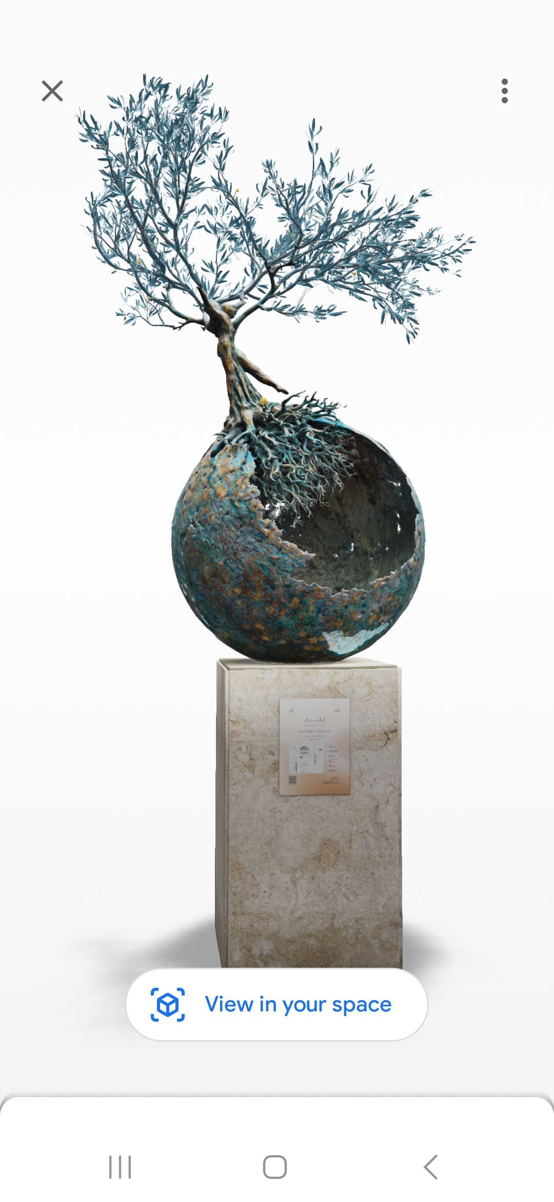

    Hello,
    When I export my object in blender into Verge3d .gltf, the object appear very dark in augmented reality when using android (ok with IOS).
    On the other hand, when I manually export it in .glb and watch it in augmented reality with a different method, the lighting is perfect.
    So I assume that Verge3d compress somehow the information for the lighting.
    How can I avoid this compressions ? (if this is the case).
    I had a similar issue with a texture resolution that has been solved here.
    PS : I use google scene viewer to see the object augmented reality since WebXr has compatibility issue with Samsung.

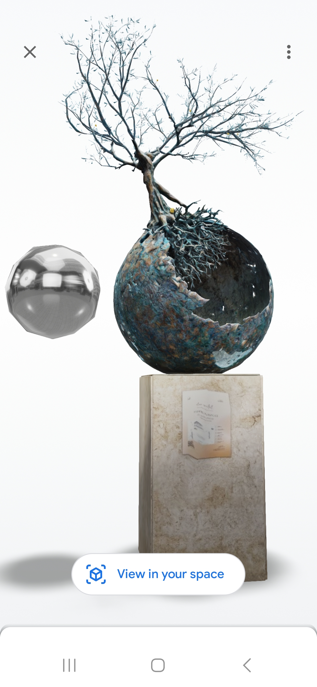

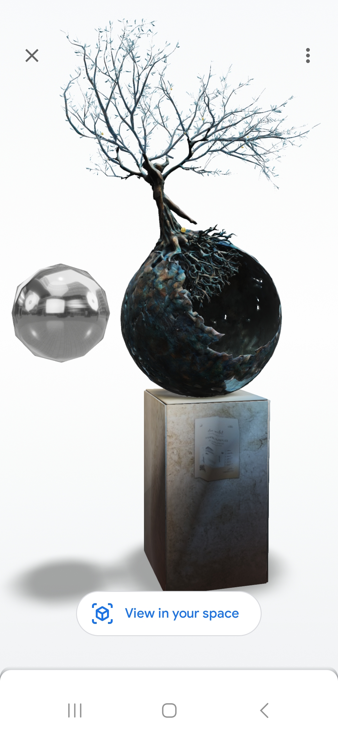

    #82052
    gestion
    I don’t have any HDRI or lights. So when I export it to Verge3d .gltf or glTF 2.0 both have the same ligting parameters (none).
    When I open them using google viewer (as I said the WebWR is not compatible with most Samsung phones), the Objets that has been exported with glTF 2.0 works fine.
    I have an issue with the object that has been exported with Verge3d though.
    In the reflection of the sphere, we can see that they both share the same built-in environment.
    I have also reduced to the max the size of the object to be sure it is not the issue.
    I have also applied scale.
    I have tried to check and uncheked the gltf 2.0 compatibility in Verge3d settings. No effect.

    #82121
    Try to export with “glTF compatible” enabled from Blender first, then export this scene using the puzzle.
    Basically, the puzzle seeks to reduce the complexity of the node-based materials before export, that’s why you might see the different results. If you load your scene with “glTF-compatible” materials first, this process should be less destructive for your shaders.
    Also, you might load your assets back to Blender to see if anything changes, possibly making proper correction in the source material as it goes.
