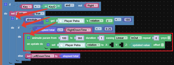

c4ccCustomer2023-10-05 at 4:46 pm #67340kdv
Participanttry to remove
absolutePuzzles and JS coding. Fast and expensive.
2023-10-05 at 4:48 pm #67341
c4ccCustomer2023-10-05 at 4:50 pm #67343kdv
Participantone of your conditions is not
truewhen needed. use debugging to find out which one.changing “absolute” to “round”
Looks like you don’t see the difference between them… Do you know math?
2023-10-05 at 4:57 pm #67344
c4ccCustomerLooks like you don’t see the difference between them… Do you know math?
absolute value aka modulus (|x|)
The round variant rounds a number to the nearest integer
2023-10-05 at 5:02 pm #67345kdv
ParticipantGood. Then why are you switching between them in that condition?
You should add
print to consoleat several places to see where the logic will stop.
2023-10-05 at 5:05 pm #67347
c4ccCustomerone of your conditions is not true when needed. use debugging to find out which one.
I remember this one was supposed to be true:
Sadly, I can’t find a place to put true puzzles with them
2023-10-05 at 5:52 pm #67350
c4ccCustomer2023-10-05 at 5:58 pm #67351kdv
ParticipantThe third condition is not true. Think. The solution is obvious.
2023-10-05 at 6:15 pm #67352
c4ccCustomerYes, we should add false. But problem is, there is no place to add true or false on the “animate param from”
2023-10-05 at 6:18 pm #67353kdv
ParticipantYou are thinking in the wrong direction
You’ve made a rude mistake in your code and don’t see it.Yes, we should add false.
No, there is no need in it. Forget about the procedure from my screenshot.
2023-10-05 at 6:23 pm #67354
c4ccCustomer2023-10-05 at 6:24 pm #67355
c4ccCustomerdeleted
2023-10-05 at 6:48 pm #67357
c4ccCustomerYou are thinking in the wrong direction
You’ve made a rude mistake in your code and don’t see it.Change LeftDownTime to RightDownTime?
2023-10-05 at 6:49 pm #67358kdv
ParticipantExactly.
