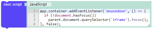

2023-04-07 at 5:40 pm #61848kdv
Participantparent.document.querySelector('iframe').contentWindow.focus();
or
parent.document.querySelector('iframe').focus();And in general, if an <iframe> element occupies 100% of a page space then this <iframe> is not needed at all.
This simple script will set focus on <iframe> if it’s not in focus
2023-04-10 at 1:26 pm #61941
cralex75Customerthanks the javascript works very well
