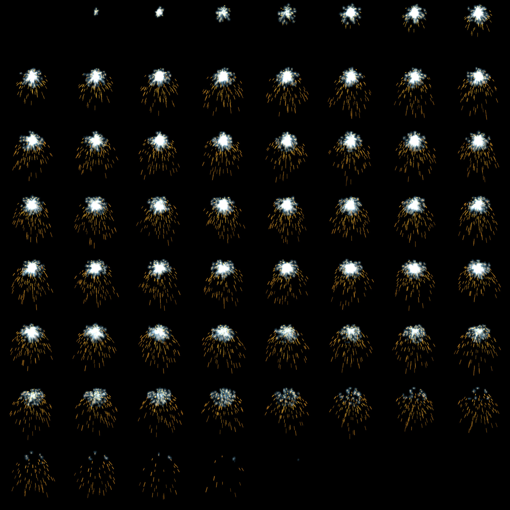

    Exporting of the image sequence is not supported. To implement something simmilar you will need to create a texture atlas for your images like this:
    Look at welding in the Industrial Robot demo.

    but its going to be an issue for me as im using over 900 frames will that even fit one image and if it does wont that trouble the optimization and is there another way to do this i have a chroma keyed video can i import it directly into the web server via puzzles
