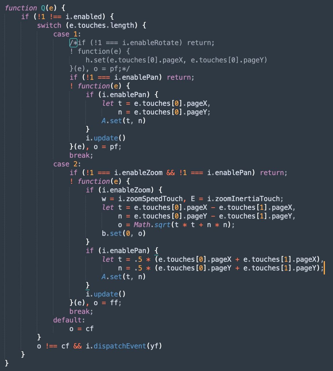

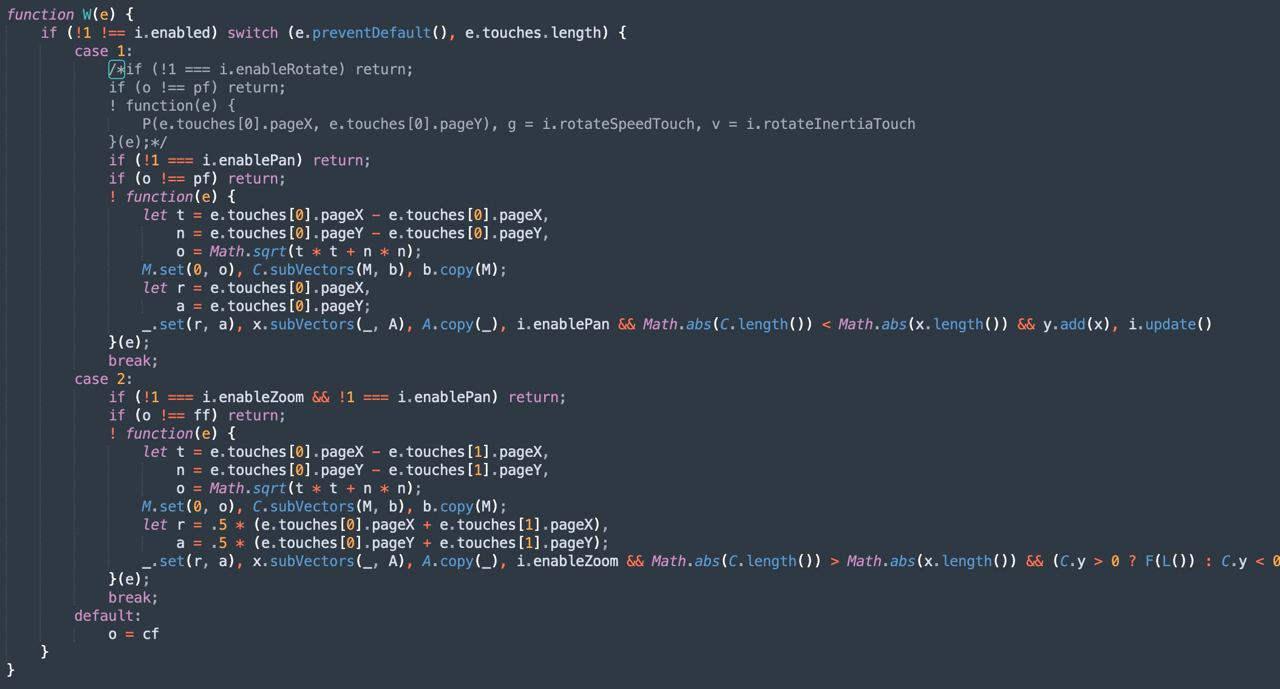

    I was able to “patch” v3 for a single touch camera pan (Pseudo-2D map explorer) But since v4, I cannot achieve this anymore. As UX goes, not sure many people would assume they need to use two fingers to pan the map. I’ve swapped the mouse pan to the left button, but touch controls are nowhere to be found. Is there a way to remap touch controls in code?

    Panning and zooming are triggered only when the second touch event occures. To force panning instead rotating you need to patch v3d.js (it’s a little complicated task) or you can use the separate class OrbitControls from THREE.js

    I did patch v3d.js in v3, but seems like v4 is quite different and my old solution is no longer viable. I’ll dig more, cheers.

    These two functions check the number of touches
    function onTouchStart(event)
    function onTouchMove(event)
    switch (event.touches.length)
    The functions handleTouchStartDollyPan(event) and handleTouchMoveDollyPan(event) require the second touch event and they will throw an error if you try to call them with a single touch only.

    It appeared not so difficult ))) Just replace all mouse events with pointer events, disable rotating and swap PAN/ROTATE buttons
    https://v3d.net/9cj

    This works for me. v4 patched.
