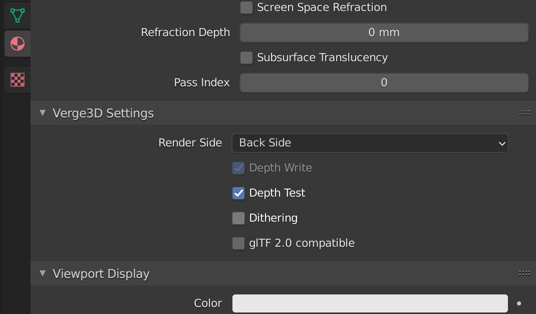

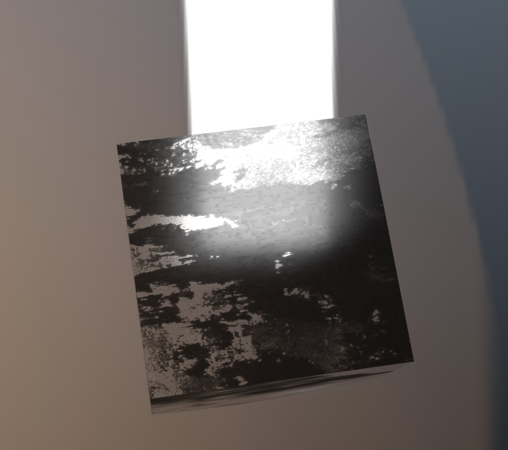

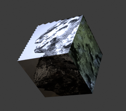

    I don’t know why but some objects in some blender files have their normals inverted when I export the Verge3D file or use Sneak Peak. I check the normals are correct in blender but when I export they are inverted. The objects also appear transparent to light if metallic is set >0 in the BSDF shader. I have attached some images and the application folder.

    Update: I changed the title to better reflect the main problem after solving the first issue where I was inadvertently rendering the back faces.
    #40658
    Looks like you render the Back side of your mesh. See the attached screenshot.
    #40662
    randyfive
    Thanks, I must have clicked that when I was trying to solve the other problem and didn’t realize what I did.

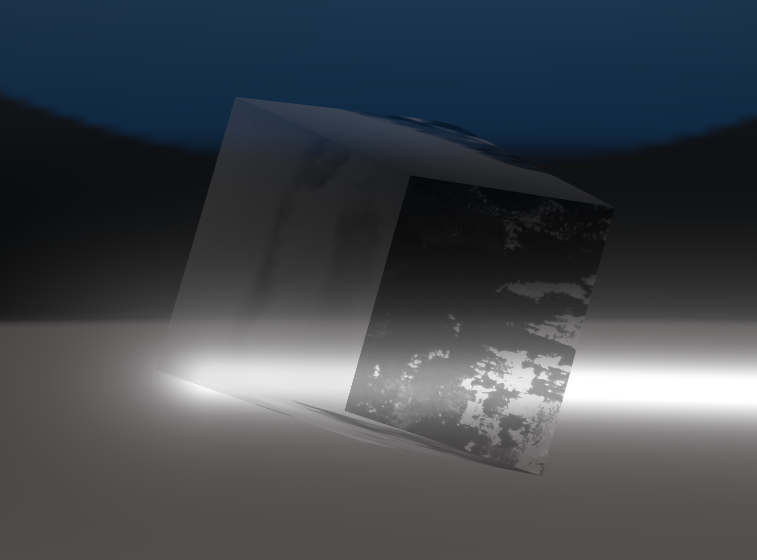

    Now that that is fixed, however,
      I still see light from the environment passing through the object even though the alpha channel is set to 1.
    See the attached image and application folder again.
    Could you take a look again at this? I can’t figure out why it is doing this.
    Thanks for your help!

    Any ideas on what is wrong with my file?
    Here is an additional video to show that I am rendering the front side but when I do a Sneak Peak, the lights from the environment pass through my model.

    This troubles caused by camera scale, if you set camera scale to 1 all will be ok.

    That fixed the problem! Thank you Mikhail!
