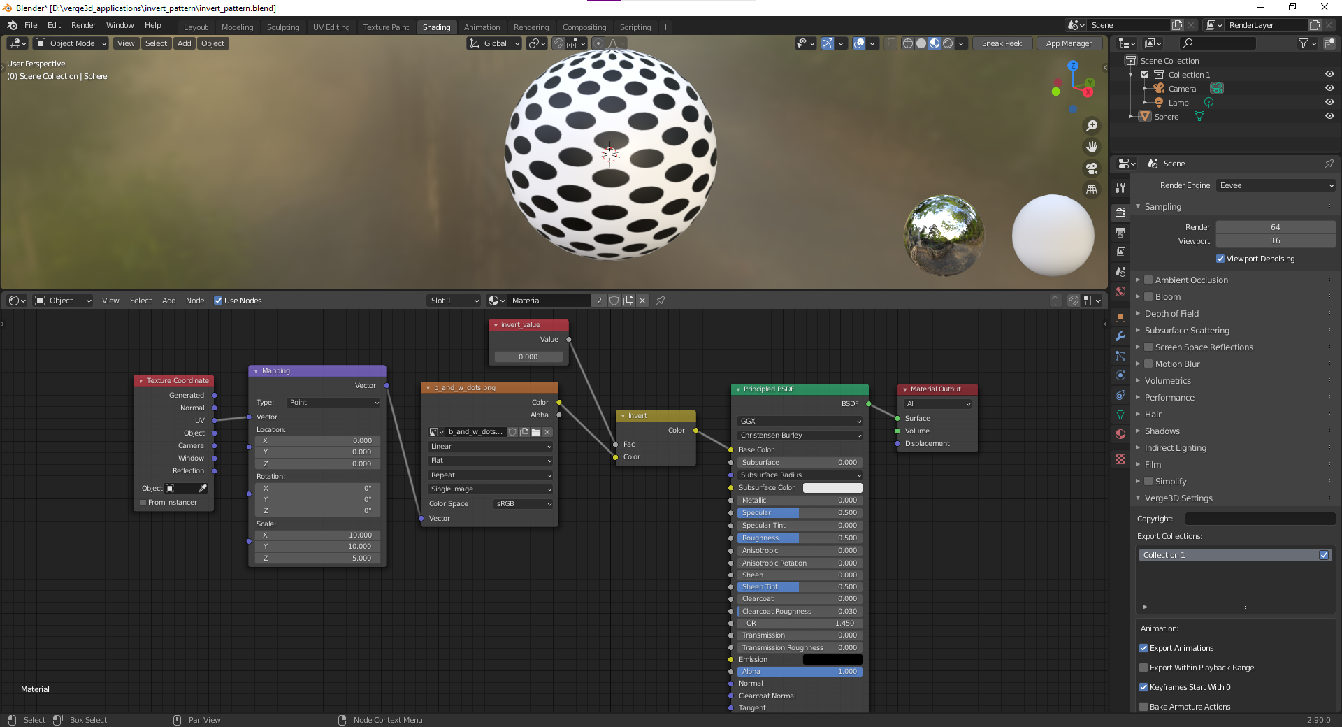

    Hi, is there a simple way I can invert a black and white texture with puzzles, so I don’t need to have an extra texture loaded in the scene?
    Thanks!
    #34778
    jem
    Hi @kagoshi,

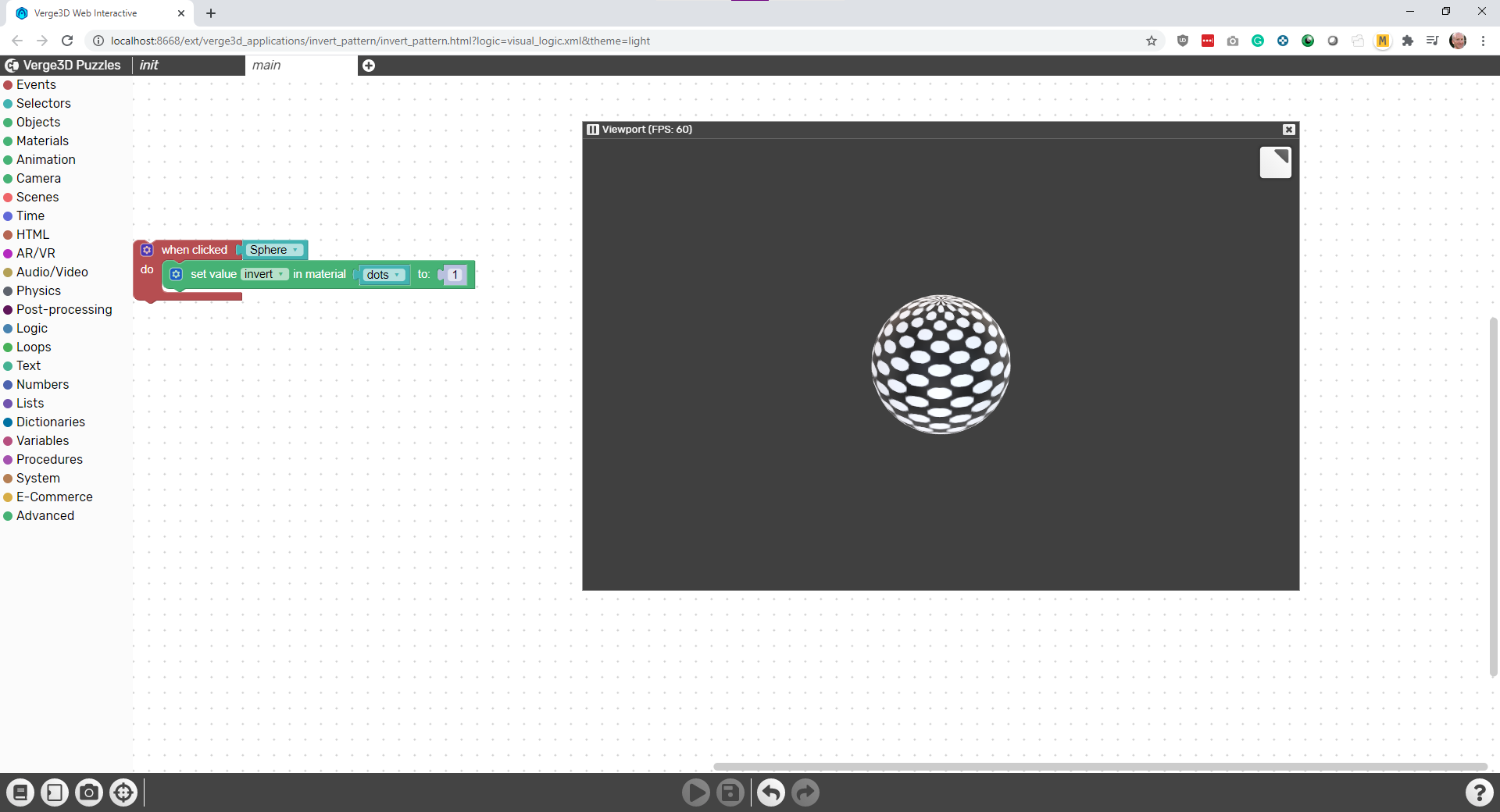

    This is easy to do. Add an invert node to your shader on the diffuse channel. Tie a value node to its factor input. A value of 0 will leave your pattern unaffected. A value of 1 will invert it.
    Values node can be set from puzzles. In my example, clicking on the sphere causes the puzzles to set the invert value to 1.

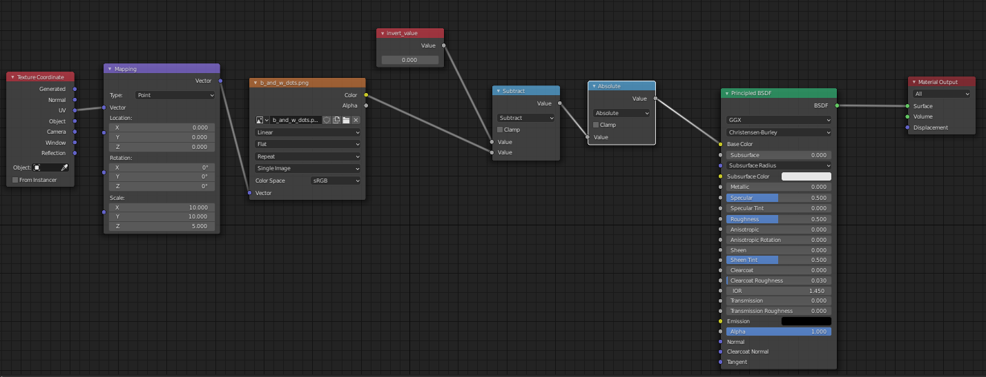

    @kogoshi, as long as the Maya version has a value node and math nodes, you can do this. The math is easy. I will assume that Maya uses a 0…1 scale for values.
    1. Get a value from the puzzles. The value must be 1 or 0. O indicates no-change. 1 indicates inversion.
    2. Subtract the diffuse value from the inversion value.
    3. Take the absolute value.
    Here is the node set up in Blender.
    Jeremy Wernick
    #34827
    In Maya you can inverse colors with reverse node. We’re going to support it (as well as many other Maya utitily nodes) in the upcoming Verge3D pre-release.
