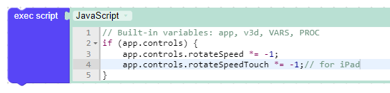

    #46144
    dssctr
    If it’s a room the puzzle should look like this.
