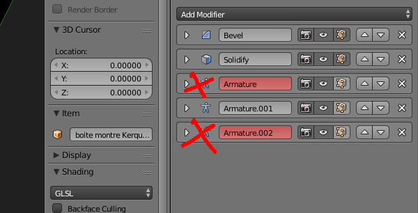

    When I export my gltf, it’s strange I am obliged to click on icon pose for has the animation names in the puzzle. When I have two object who utilised some bone, only one of them can be export. Why ?

    Can you share the example?

    A lot of thanks for your clever eye, I was catch by bad luck ! The answer in the image.
    #7833
    Hi vincent,
    We fixed this bug, it should work in the next release. If an object has multiple armature modifiers, then the first valid one will be used for export.

    As I can remember first time you send me a blend file with three separate bone system with single bone in each for rotating each box cover separately, so you have three bone system fro the box with three armature modifiers. May be you just forgot to delete two of them.
