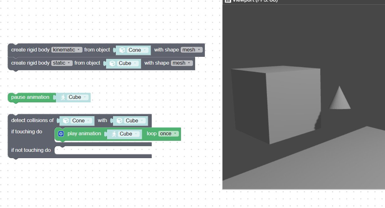

    I have a transparent object attached to the camera and when it hit a static object in the scene, animations will play.
    I tried but didn’t work.
    #41903
    This is known limitation of the physics engine. You can’t detect collisions between static and kinematic, static and static, kinematic and kinematic. Please assign one of the object to ghost or dynamic to make it work.
    #41907
    Philip Fong
    Thank you very much, I got it now. :good:
