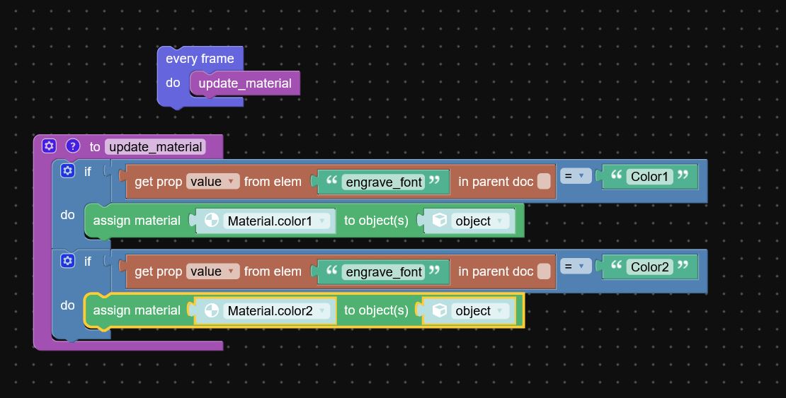

CustomerI use the engraving selection menu from the jewelry app exmple.
I want to customize the menu to use it to change the color of my object.But how to get the information which color has been chosen from the drop-down menu?
So I can use it as input for a assign material puzzle.
In other words, how to read out the menu chosen option?Something like html puzzle “get prop option_value from element id: engrave_text”.
But then it has to get the option value. I don’t know how to set this up in puzzles (or html)Attachments:

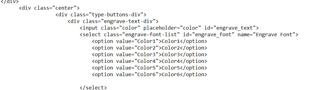

2023-08-11 at 11:32 am #65997kdv
Participant<option value="#00ff00">Green color</option>Puzzles and JS coding. Fast and expensive.
2023-08-11 at 11:54 am #65998vision
CustomerHi kvd, good option!
However I meant more in the manner of puzzles. I have not only colors to assign but also textures. So I like to keep the html to a minimum and build the flexibility in puzzles.I think I figured out how to read the outcome of the select menu. So I now am building a structure for assigning material for the choosen color. A lot of if statements..now only with 2 colors for test but there will be a lot more added when it is working.
What I have right now it this:Attachments:

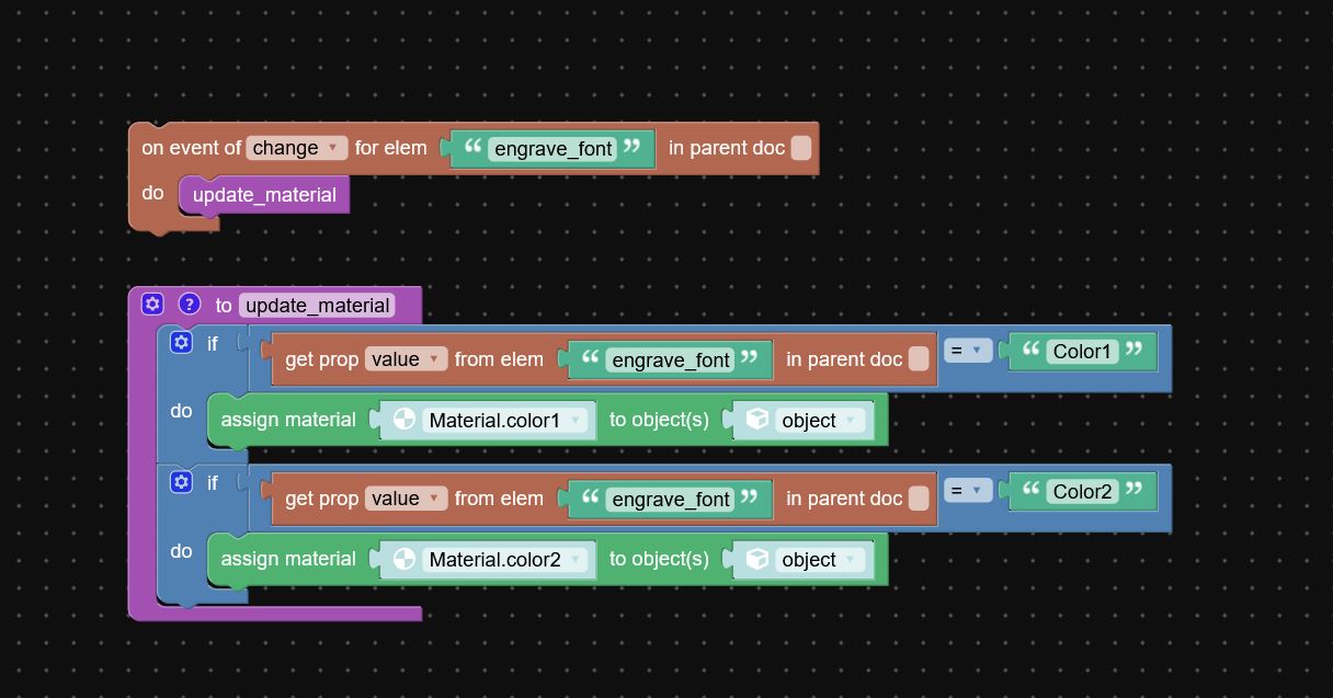

2023-08-11 at 12:05 pm #66002kdv
Participantassigning material every frame?
There is a cool puzzle that can add event listeners for different actions
https://www.soft8soft.com/docs/manual/en/puzzles/HTML.html#eventPuzzles and JS coding. Fast and expensive.
2023-08-11 at 12:20 pm #66003vision
CustomerYou’re right, every frame doesn’t make sense. But it was not working, so I just was trying.
Now added the on event puzzle, not working at the moment, but this is the better structure.
2023-08-11 at 12:23 pm #66005kdv
ParticipantIn your case options may be represented this way
<option value="Material.color1">Color1</option> <option value="Material.color2">Color2</option>
2023-08-11 at 12:44 pm #66008vision
CustomerThis is exactly what I was looking for, also the efficient way. I keep thinking, there must be a more direct manner of assigning the material with the menu value. then al lot of if statements and variable.
