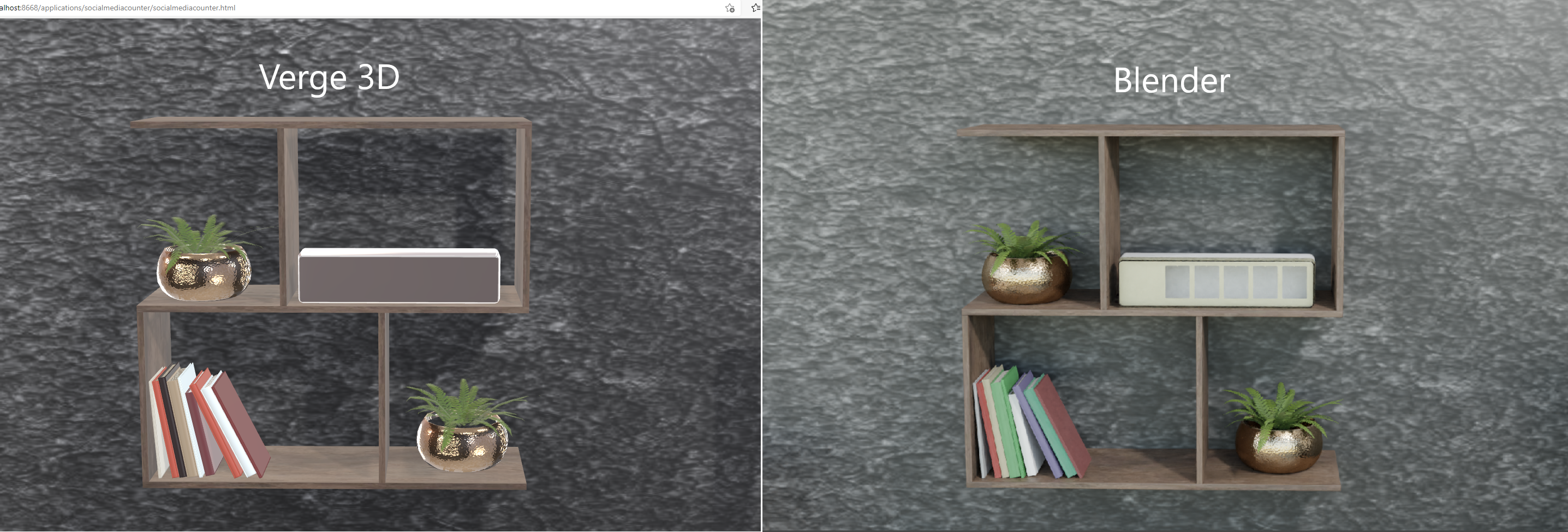

    I have created a 3D environment.
    There is a problem:
    Verge3D gives different materials to objects than blender itself does. Also, transparent (glass) is not visible. I need to be able to look through an object to see the product, but in Verge3D this object gets a color. In the attachment you can see the difference between the render and Verge3D.
    Is there any way to get the same realistic materials and colors in Verge3D? I really hope this can be easily fixed.
    Thanks in advance,
    Daan
    #49340
    THe only way is to bake all lightings and materials. And you need to caompare EEVEE with Verge3D not Cicles render.
