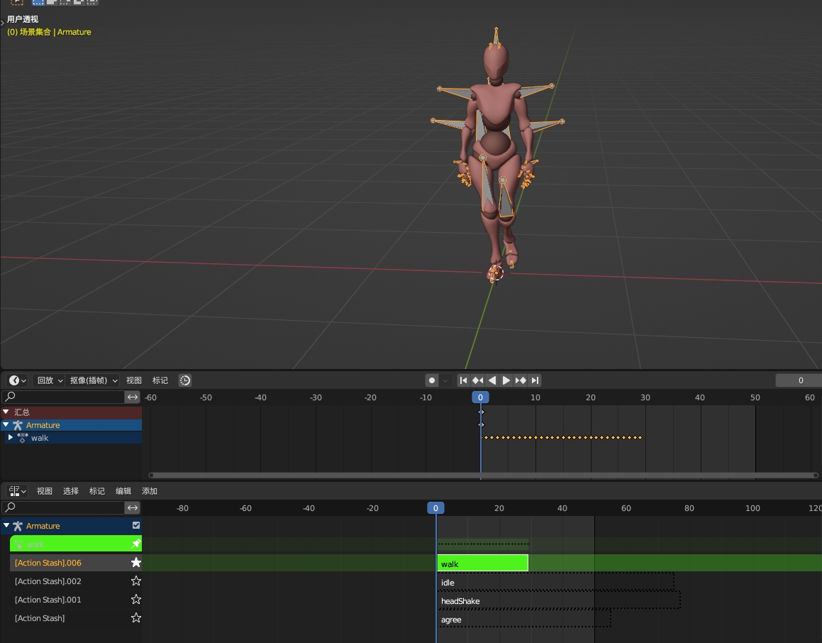

    How to get and control additive animations using Puzzles or Execute Script in Verge3D?
    I’m trying to access and control additive animations similar to the official demo:
    https://cdn.soft8soft.com/demo/examples/webgl_animation_skinning_additive_blending.html
    I can play basic animations using Puzzles, but can’t seem to get or control the additive ones.
    How to get the list of additive animations?
    How to enable and blend them via Puzzles or JS?
    Thanks.
    #83225
    Unfortunately, the additive animation is not yet supported in both exporter and Puzzles. As a workaround, you might bake all possible combinations in one lengthy animation.
