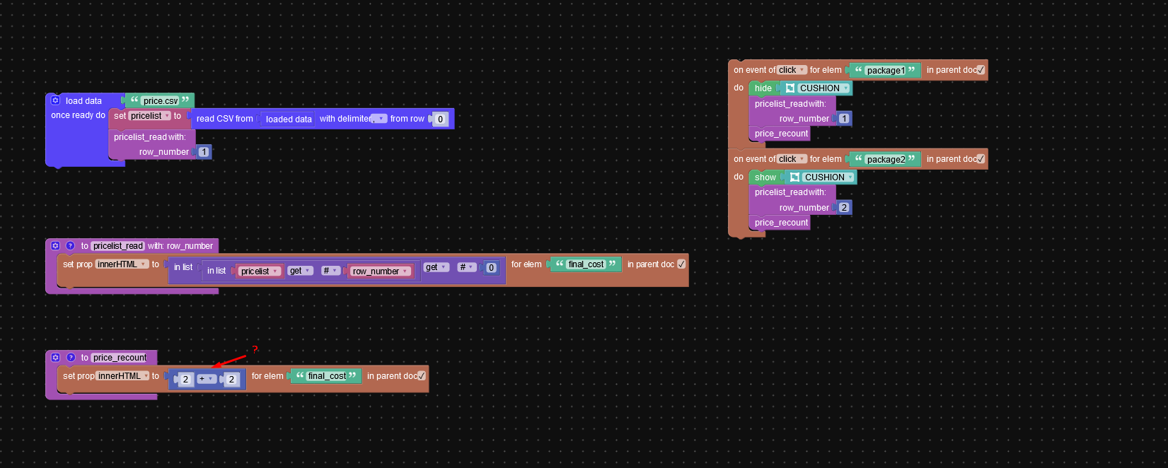

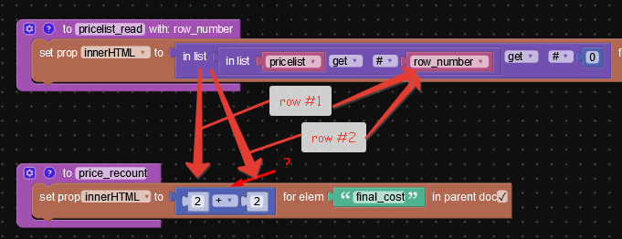

    I’m trying to make a price calculator to read values from a local csv file and than doing the sums of the prices.
    Right now the final_cost is reading correctly the values from the .csv gile but looks like i’m not able to do the sum
    What should i insert into the price_recount puzzle in order to have package1+package2?
    Thanks!

    giorgioz
    http://prntscr.com/m8VBnG0As_mK
    if i use this than the final_cost is showing the single values, not the sum
    am i doing something wrong?
    thanks for the help!

    #66429
    giorgioz
    Thanks! This is working correctly now
    What i have to do is creating a sum of multiple object that follow more or less this logic:
    Starting price 1$ + accessory1+ accessory2+accessory3+accessory4 etc…
    You can add different objects that will keep stacking the sum (you can toggle on and off the objects)
    You were mentioning that using a loop is the best option, how can i use it in the best way?
    Thanks a lot man!
    #66433
    Create a correct .csv like this
    accessory1_name_as_in_3D_editor;price1
    accessory2_name_as_in_3D_editor;price2
    accessory2_name_as_in_3D_editor;price3
    Use a loop to search for visible objects in this pricelist and sum their prices.
