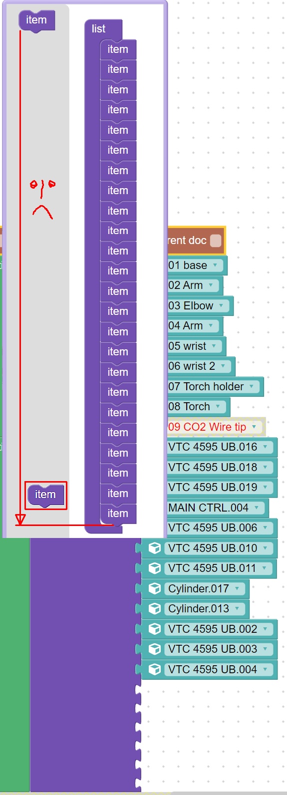

    Hey
    guys
    Can we allow this little buddy in the “list” puzzle to drag to lower positions where it will be helpful to avoid unnecessary kilometers of mouse travel? Especially when the list grows more and more.
    Collection making can be the first way out to reduce efforts but still feel that, if this featuer allows place it lower position by dragging it will be convenient.
    OR
    Can we just add a number of items by entering number value? easiest way either.

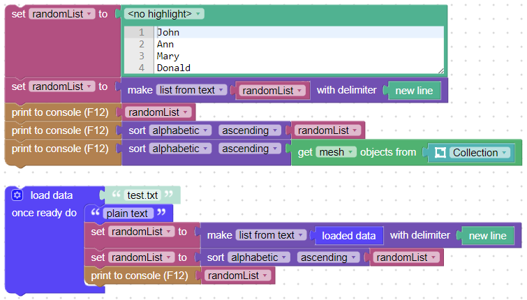

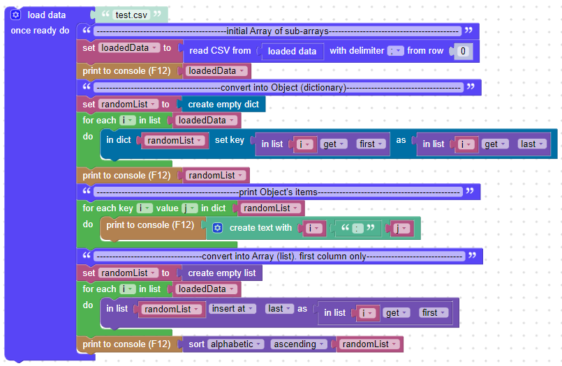

    Use “sort” puzzle if it’s crusial for you to have items in some order (numeric or alphabetic). Or you can create a list from a multi-line text. Or you can place needed objects into one collection in Blender and then create a list of objects of that collection in Verge3D. But CSV is the best way for large arrays.
    #66158
    It would be great to have some sort of item manager that would allow you to visually sort the item stack so you can quickly determine if something is missing. Or if your like me, I just like neat and tidy things, so a list is either short and easy to man age or I use KDV’s suggestion of using a multi-line text puzzle. When that gets to be problematic…you can always load in a CSV or JSON file and do things starting from there.
    In the case of a robot we recently completed with 1000s of parts, our lists were better managed by CSVs in some cases where we could update or modify using a spreadsheet, export and V3D would pick it up from there.

    can you show any example of multiline text puzzle or CSV ?
    if that makes life easy then whats harm in trying?
    #66162
    plain text
    #66166

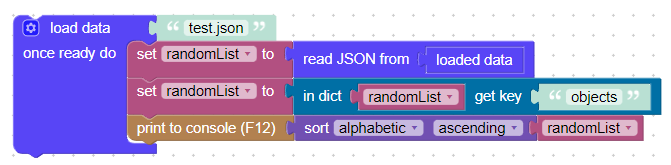

    json

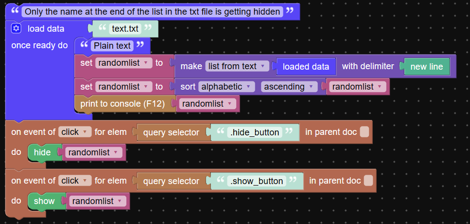

    saurav
    I went through and was successful in implementing the suggestion kdv gave.
    I had another concern that if I was previously using this list to hide suppose 5 objects out of a collection of 10 objects. Then how can I do that using this list suggestion kdv gave.
    Like, if I use the plain text method or Json method I am not able to hide the objects as I was able to before by using the lengthy puzzle approach of making the list.
    What I did was I added the names of the objects I want to hide in the text file and used hide puzzle. And this didn’t work.
    Is there some way to get this output using this text file method/ Json method.
    #66248
    Show your puzzles. It has sense to use external files only in case you want to create really large lists…

    #66272

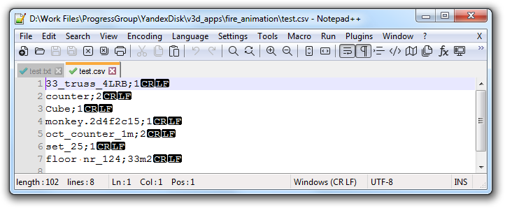

    CSV (in Excel and text editor)

    saurav
    Hi, I used this approach to try and hide some cubes from my 3D scene,
    The approach in which .txt file is used I have 5 names added in the .txt file but only the last i.e.,5th object gets hidden when I click on ‘hide’ button.
    Then another approach in which json file is used is not working altogether, none of the cubes mentioned inside the objects list is getting hidden.
    Please refer to the photos added and share the solution for the problem I am facing.
    #67002

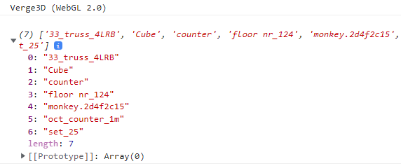

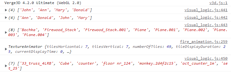

    you’re using the “print to console” puzzle. so you can see in the console log the resulting list of objects and this list should look this way

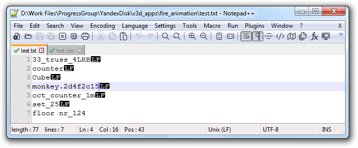

    Most likely the reason is in your text.txt. You should use a text with the Unix end of line (LF or \n), not the Windows one (CR LF or \r\n). In puzzles new line returns \n.

    saurav
    Thanks!
    Though I am not able to see the ‘LF’ or ‘CRLF’ in the notepad++ but my example is working now, will keep an eye for such mistakes coming forward.
