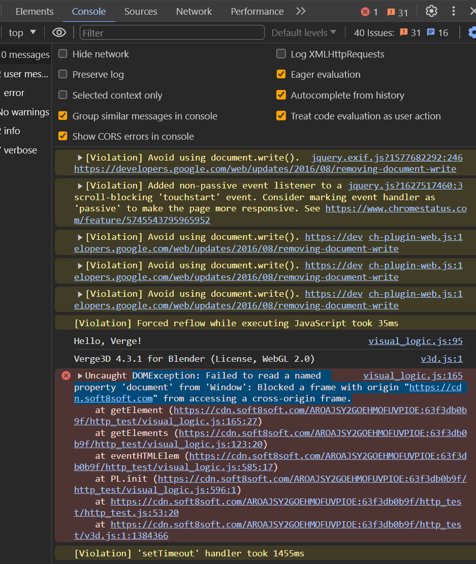

    Hi, When I embed a v3d code in my webflow project and try to host them on our own hosting server (with HTML, CSS, Javascript exported), it throws me an error saying ”
    DOMException: Failed to read a named property ‘document’ from ‘Window’: Blocked a frame with origin “https://cdn.soft8soft.com” from accessing a cross-origin frame.”
    This seems happens because I am not hosting custom html and javascript files on the verge3d network, but on my own hosting server (like ecommerce platform like shopify), it gives me Same-Origin Policy error. Accrording to Stackoverflow, they suggested a workaround this issue by using window.postMessage and window.eventlistener to avoid this iframe-cross domain access issues.
    Why are you loading the app’s files from soft8soft.com? Can’t you upload them to your server? It will solve your problem.
