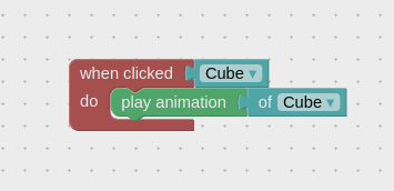

I attached my blender scene screen shot below.
there is nothing yet on my js file…
I want to animate my cube by clicking btn(the gray box).
I want to code does event without using Puzzles.
For now, my brain is empty and I don’t know how to get started.
Can you help me to solve this question?

I’d seriously recommend using Puzzles at least for some parts of your app.
For example, the click-and-play example that you mentioned can be done with just 4 puzzles. However it requires 200+ lines of code to implement it! (see the attached files).2018-03-15 at 8:04 am #2905

2018-03-15 at 8:09 am #2906jay
CustomerOh ok. I try to do some puzzles with code~
Thank you for answer me~!
2018-03-15 at 9:00 am #2917jay
Customeroh it works~! you are amazing
