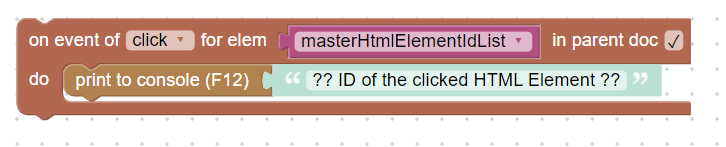

    I have a list of text strings that represent the ID’s of all of the HTML elements that I have created on a webpage (using Webflow to create the HTML elements).
    I am able to create an event listener for this list which triggers whenever I click on any element whose ID is in the list (see attached screenshot), but I can’t figure out how to access the specific ID of the element that was clicked.
    Do I need to just create a separate event listener for each element and hard-code the name of the element ID, or is there a more efficient way to do this with a list of IDs? Need to use custom JS code instead of puzzles to accomplish this maybe?

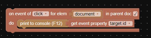

    I don’t think the list is necessary , try this puzzle setup
    it will print any ID that you click.

    Thank you! Sorry for the rookie question. Still getting familiar with all of the available puzzle options. Glad you were willing to help!
