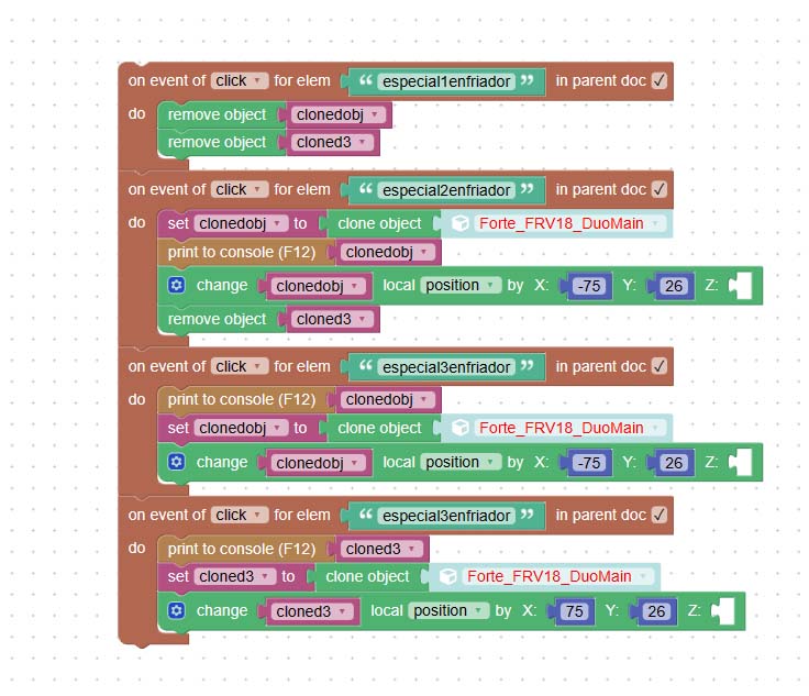

CustomerIm creating a fridge configurator that allows you to visualize up to 3 fridges as the last step
My question is, once i have the fridge ready, how can i limit the amount of fridges when they click 2 or 3 fridges?
It works well with the puzzle i have, but if the user first clicks 2 and then 3, or viceverse, 3 and then 2, it generates more clones and i cant remove them from the scene when the user clicks “1” or goes back to the configurator.

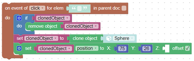

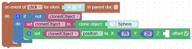

ParticipantRemove clones before creating the new ones. Or do not create the new clone if it already exists (prefered).

Tutorials - https://www.xeons3dlab.com2023-06-23 at 1:30 am #64807kdv
ParticipantDiscover the magic of the non-linear logic…
Remove before cloning if exists
Do not clone if already exists
