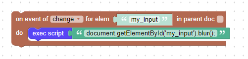

    #51496
    You can do that with a little bit of js. The solution is to remove focus from the input element when a user enters a value. If you know the element’s id you can do it like this: document.getElementById('my_input').blur();
    And it’s easy to add that in puzzles:
