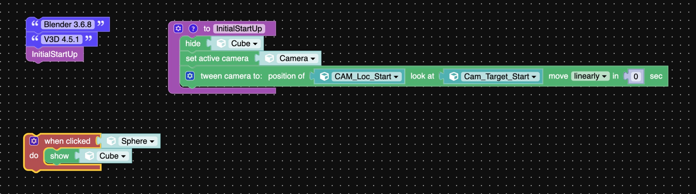

xeonCustomerjust place a hide object puzzle at the start of your puzzles.
then add a show puzzle to the when clicked puzzle for the object you want to make it appear.demo: https://v3d.net/pjh
The image below shows how I typically start a project:
The first thing are two comments:
Version of the 3D software and version of Verge3D that I am using.The next thing is my initial procedure.
I place items in this that only need to be defined, set or initialized the very first time the application loads. In my use cases this differs from a reset function that I may have that resets the scene to the beginning similar to a initialize but doesn’t require reloading of assets.Although the contents of the procedure could be placed outside a procedure I like to keep things tidy and not have erroneous puzzles laying about that can be executed out of the intended order so for me … everything must be in a procedure or event trigger as quicky as possible.
Inside the procedure…the first puzzle is the hide puzzle. In this example it hides the cube.
The next thing I do is define the camera (optional) and make sure the camera is at the starting location and looking at the specified item (optional). If you ever opened up the AppManager and your app and find you camera not where you expect. These are simple way to make sure that doesn’t happen.The next item is an event trigger in this case a When clicked puzzle for the Sphere object.
It has the show puzzle that unhides the cube when the sphere is pressed.Thats it.
Hope this helps.

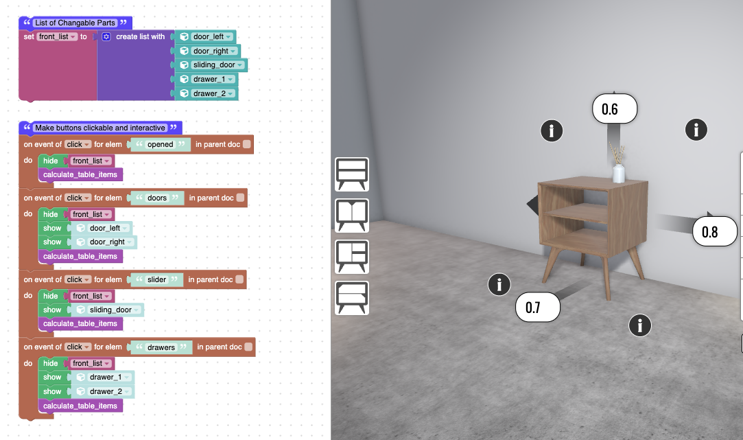

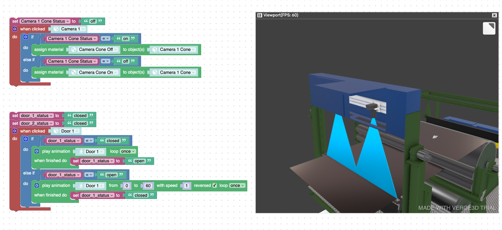

ClaasParticipantHey Xeon
I think I slowly start to better understand your comment.
I was looking at the furniture configuration file and saw how they use a list to show hide parts
see first attachment image
going back to my own work and looking at what you said – this is what I have right now
so I should not set a state outside the “when click” puzzle module?look at the second image attachement

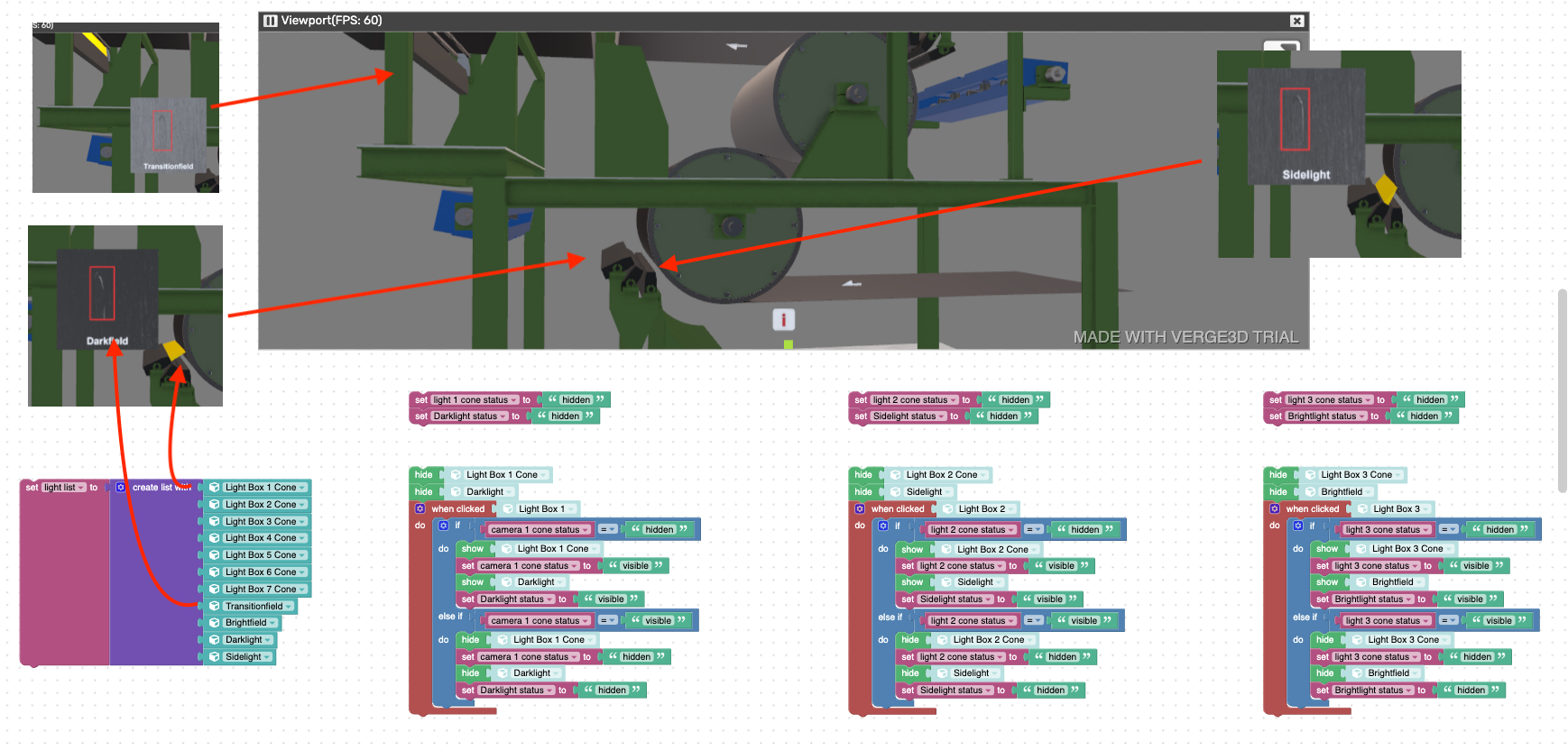

I was also curious here how to better work with lists to shorten the lights on off task.
in the end when I click a light all others should be off plus their error images should be gone.only the light clicks should show the light cone and error image.
do I feel I am close but something I do seems not correct
I am pretty new to all this

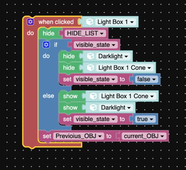

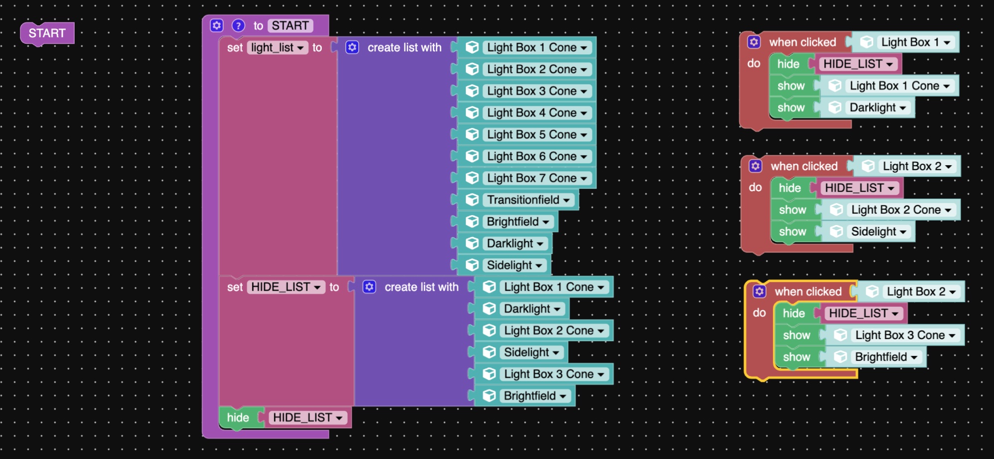

2024-02-23 at 11:20 pm #70981
xeonCustomerYou can try something like this:
Just a word of advise….keep things as simple as possible- hanging or loose puzzles will be executed first so having them laying about your puzzle space and not grouped will at some point cause you grief trying to track down an offending puzzle. I also recommend putting those puzzles that you are initiallizing your scene into a puzzle…so you can control the flow of execution otherwise you have to worry about where vertically and horizontally you layout your puzzles as there is an execution order based on horizontal and vertical alignment. Needless to say that adds to the messiness of trying to debug something.
Since you want everything off and just want things to turn on when an object is clicked you can simply your puzzles down.
you actually don’t need the lightlist as I have it…its not needed but maybe something your scene required elsewhere.
Tutorials - https://www.xeons3dlab.com2024-02-23 at 11:48 pm #70984

2024-02-24 at 12:15 am #70985
xeonCustomerWell… I think before we go round and round adding things after I supply a solution we should define all the requirements.
Is this latest twist the only addition or are there others after this that need to be considered?
Tutorials - https://www.xeons3dlab.com2024-02-24 at 1:00 am #70986
xeonCustomerthis is one way…but it assumes you want to toggle the WhenClicked event.

while puzzles is pretty simple there is still some understanding needed to know what will do what2024-02-24 at 2:51 am #70993kdv
Participantwhen I click one light objects the light cone and error message is displayed
if I click the same light object again the cone and error is hiddenJust check visibility.
