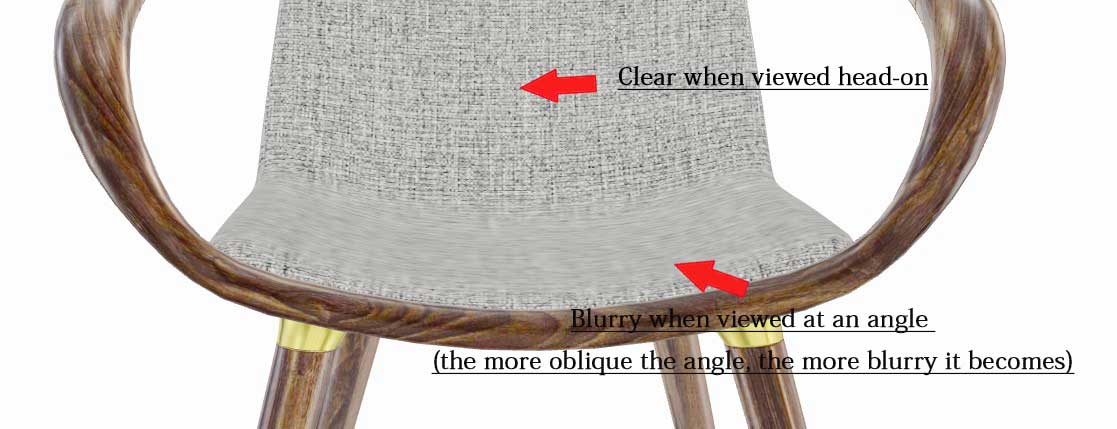

    yao000008
    I’m experiencing an issue with one of my textures in Verge3D, where it appears clear when viewed head-on but becomes blurry when viewed at an angle. I have tried adjusting the texture filtering settings in Blender to “Nearest” , which resolved the issue in Blender but didn’t have any effect in Verge3D.
    I would appreciate any advice or suggestions on how to address this problem in Verge3D. Is there a specific setting or approach that I need to apply within Verge3D to achieve the same “Nearest” filtering effect as in Blender?
    Thank you in advance for your help and support.

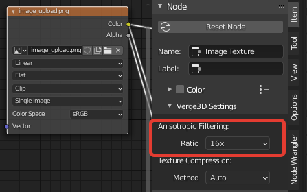

    #61495
    Set anisotropic filtering to 16 in Blender.

    #61508
    yao000008
    You perfectly solved my problem, thank you very much :rose: :rose: :rose: :rose:
