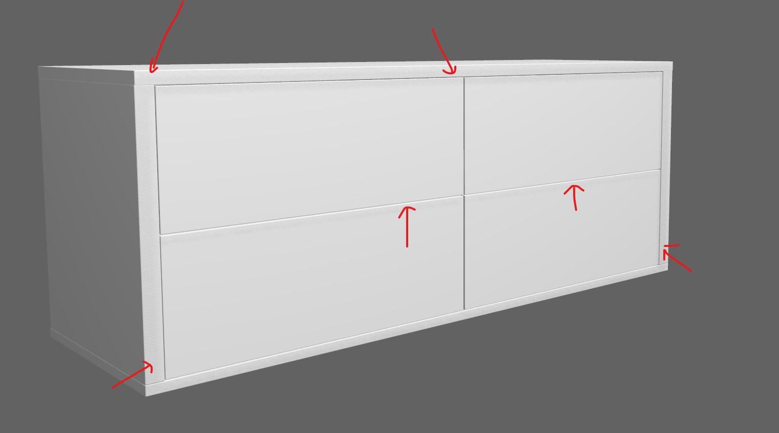

    Hello. I’m trying to make a simple shape but gray distortions appear in the browser… what could this be?
    I would be grateful for help because I don’t know what to look for

    Cant be sure without seeing the model but my guess would be that your UVs margin is too small or that that edge of the UV position is close to another section of the map with a different color and your UV edge is sharing that space or your UV map is at or near the edge of your texture and its not repeating.
    #69691
    Do you mean parallel lines? Actually the issue is not quite clearly depicted.
    #69702
    kuglaz
    I am posting a link so you can observe these distortions – they are clearly visible when the drawers are closed… they disappear when they are open.
    https://lukaszsiwik.pl/projekty/M-RS6_4/M-RS6_4.html
    #69703
    That’s self-shadowing artifacts. Reduce the blur radius (in Verge3d settings for lights) from 3 to 2 (or disable shadows at all) and they will disappear.
