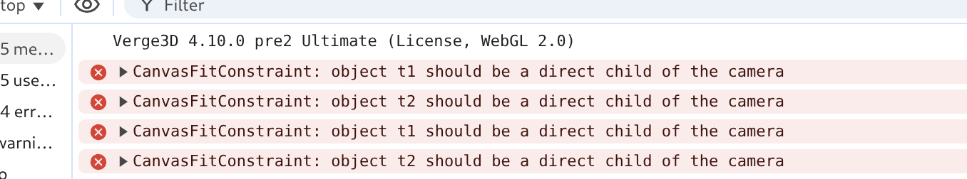

    You might open the browser console to see if there are any issues printed there. Fit to camera feature should work exactly the same for exported gltf and Sneak Peek.

    #82623
    The console clearly states that the parent inverse matrix should be cleared for both t1 and t2:
    BTH, considering the high prevalence of this problem we decided to implement checks and a warning message right on the “Fit to Camera Edge” panel in Blender. New feature will be available in the upcoming Verge3D update.
