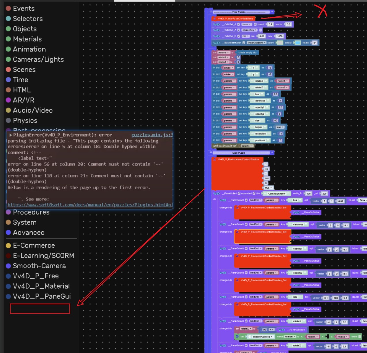

    I’ve received several emails regarding plugin usage issues, so I’d like to summarize some important notes for everyone:
    1.Verge3D version must be 4.7 or above (as this is when the Pzlib library was included). If your version is too old, please upgrade Verge3D. There’s no need to upgrade your 3D software unless necessary.
    2.If the plugin menu doesn’t appear on the right side of the Puzzles editor after installation, please check the browser console for any error messages.
    In one case, an init.plug file caused an error due to comment lines.
    3.If you see red puzzle errors, and they are not related to the plugin itself, you can safely delete them and save the project.
    These are usually development helper puzzles that I sometimes forget to remove.
