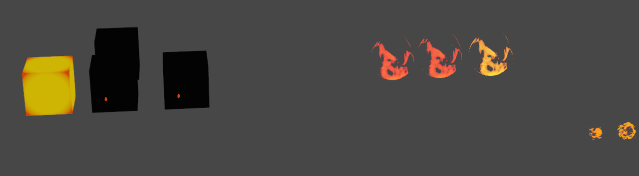

    c4cc
    procedural flames shading examples:

    c4cc
    That’s certainly a good tutorial, however, notice these flames are “whole”, not comprised of clumps, as opposed to the one in the tutorial

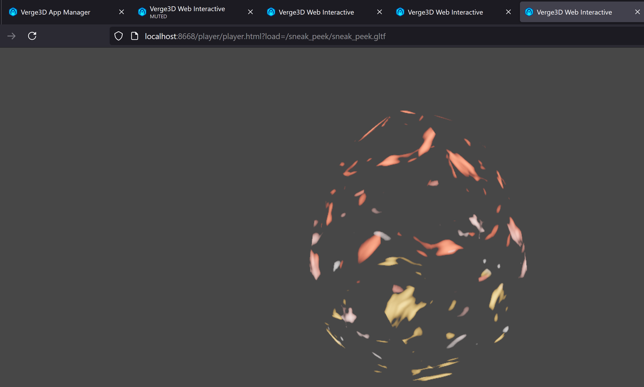

    c4cc
    export this shader to the engine
    What do you mean?
    Yes, I checked in sneak peak:
    https://postimg.cc/BLD8GJNb

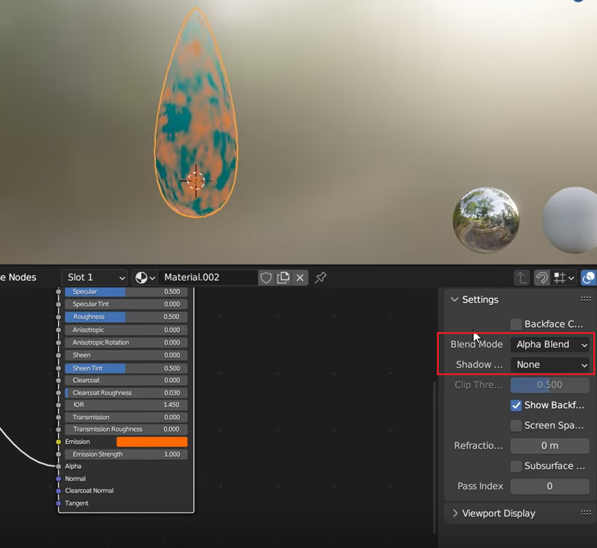

    c4cc
    Hi c4cc,
    You might check out this tutorial
    Also, at 10:46 for that tutorial, I can’t set the “Alpha Blend” and “None” as I’m using Blender 4.2
    #77201
    c4cc
    Where does it say here the options do I set in place of “Alpha Blend” and “None”, in the material settings?

    #77225
    c4cc
    How do I know which option to use in place of alpha blend/clip and none, as here?

    #77234
    So here is an answer to the question about emission color:
    (may take some time to process the vid)
    It looks a bit different in new Blender, but if we follow all the steps from tutorial, it will still work just the same!

    #77248
    c4cc
    Thanks for your answer, it seems to work. However it seems that verge3d is a little blurry compared to blender.
