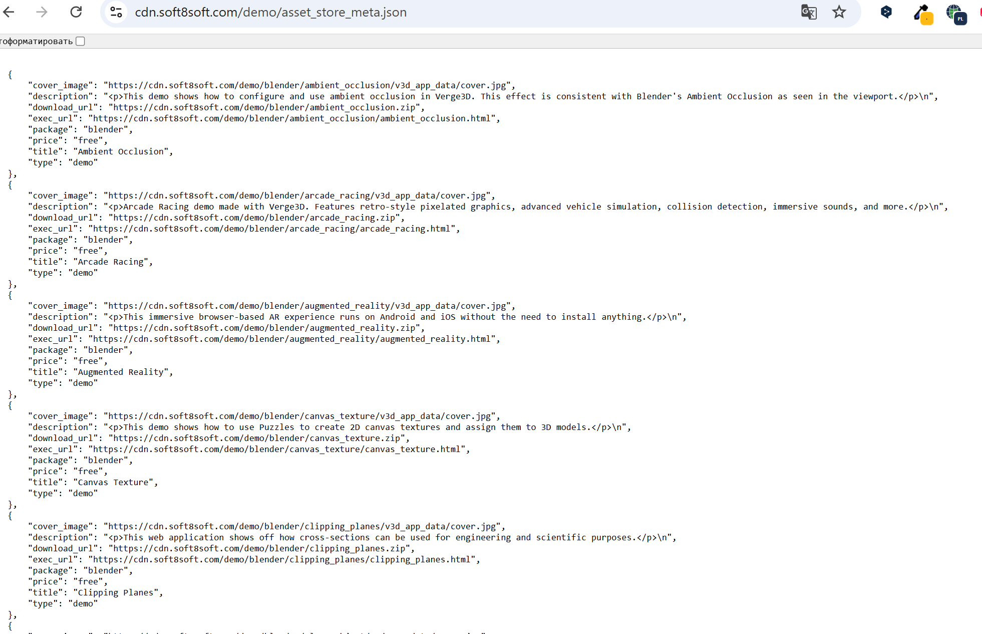

    #82914
    I see, though VPN should help. Does the direct asset store metadata link works for you (when opened via browser)?
    https://cdn.soft8soft.com/demo/asset_store_meta.json
    X | FB | LinkedIn
    #82915
    dumspiro
    #82921
    Is it with or without VPN?
    X | FB | LinkedIn
    #82922
    dumspiro
    Vpn
