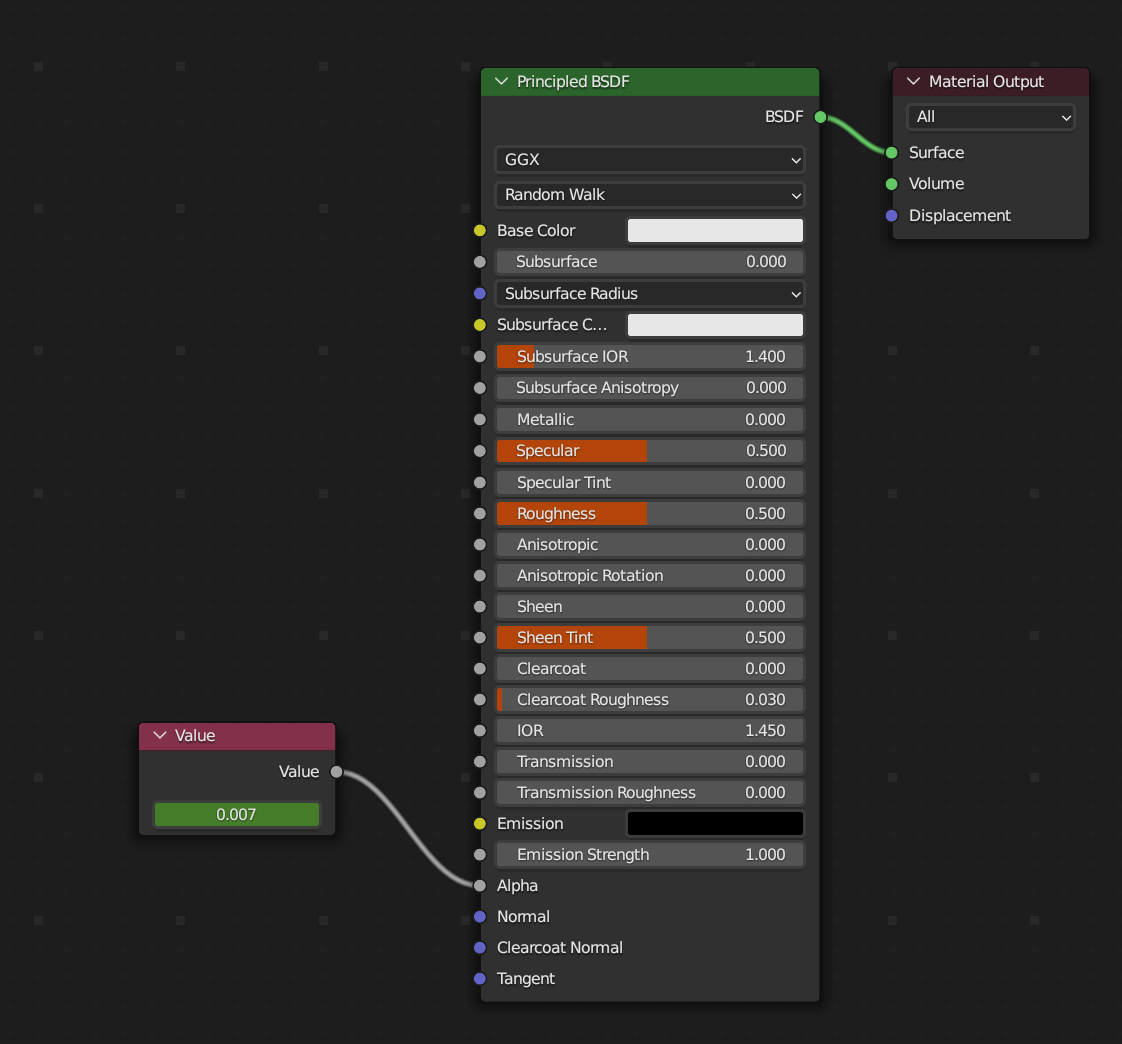

    #60952
    If using Blender you can do something like this in its simplest form.
