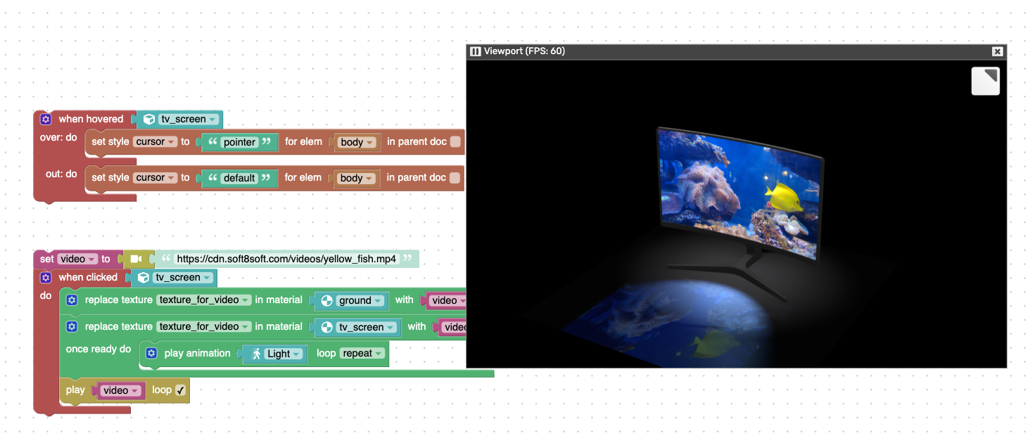

xeonCustomerAn option if trying to do via puzzles. No additional overhead cost and you can use an linked video source.
Tutorials - https://www.xeons3dlab.com2022-06-08 at 1:21 pm #52797
PascalCustomerVery clever solution how to fake the reflection. Might work in some cases.
But I recognize the frame-rate drops extremely in Firefox when I use video textures, so I am using it sparingly for now.
