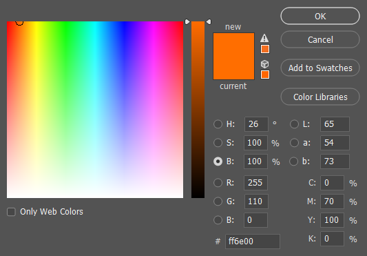

    I’m using the Filmic view transform for my application and getting the results I expect. However, when adding emission shaders for a UI element, the color is not what I expect. I know this has to do with the black magic of color spaces and color management and gamma, but I still don’t know how to use Filmic and have a specified color appear in my application. Anyone else doing something like this?
    My HEX value and desired color:
    hex

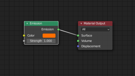

    Blender nodes:
    nodes

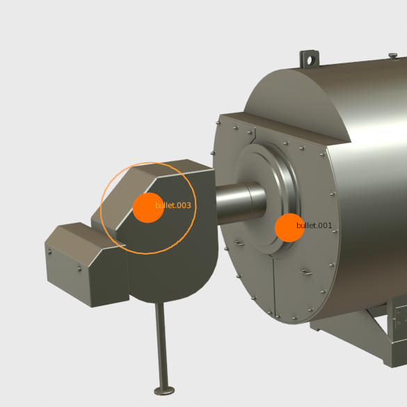

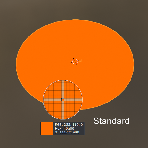

    Standard view transform (desired color):
    standard

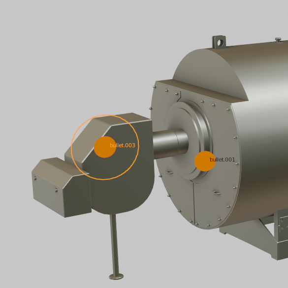

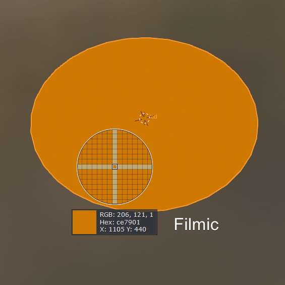

    Filmic view transform (not desired):
    filmic

    As discussed above, the model is using the Filmic view transform, while the orange dots are using the standard transform. This gave me the look I wanted on the reflections in the metal while giving me a specific color on the bullets. This is the color of our brand, so it was important to hit it as accurately as possible.
