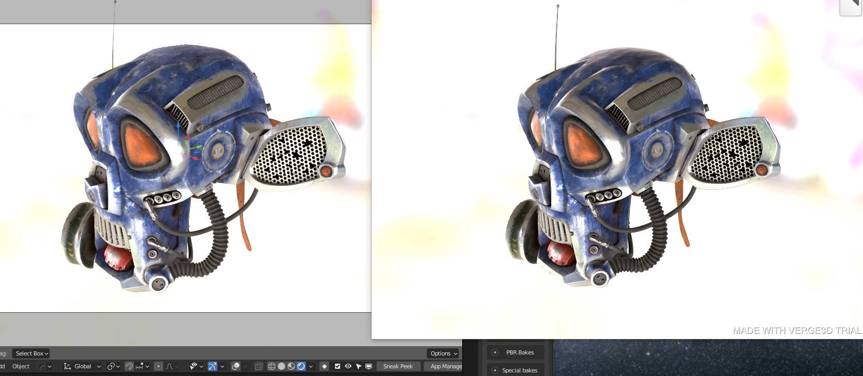

ParticipantWhat is the secret to get Verge3D looks like Eevee? I followed the Swiss Army Knife tutorial with my own test project. The result is very different. It’s as if they are not using the same HDR map, but they are.
2022-03-20 at 2:28 pm #50416
Mikhail LuzyaninStaffVerge3D uses HDR that connected to Background node, may be you compare it not in render mode but in preview?
2022-03-20 at 5:59 pm #50417x9studio
ParticipantI made that mistake the last time when I posted the question here. So I made sure that it is in render mode this time.
In my comparison rendering screenshot (the 1st attachment image), one on the left is Verge3D web browser and Eevee rendering on the right. They look so different.
The scene has no lighting object, it only uses HDR map. Verge3D web browser result should look very close to Eevee rendering, correct? Are there other settings in Blender or Verge3D that caused this? Thanks

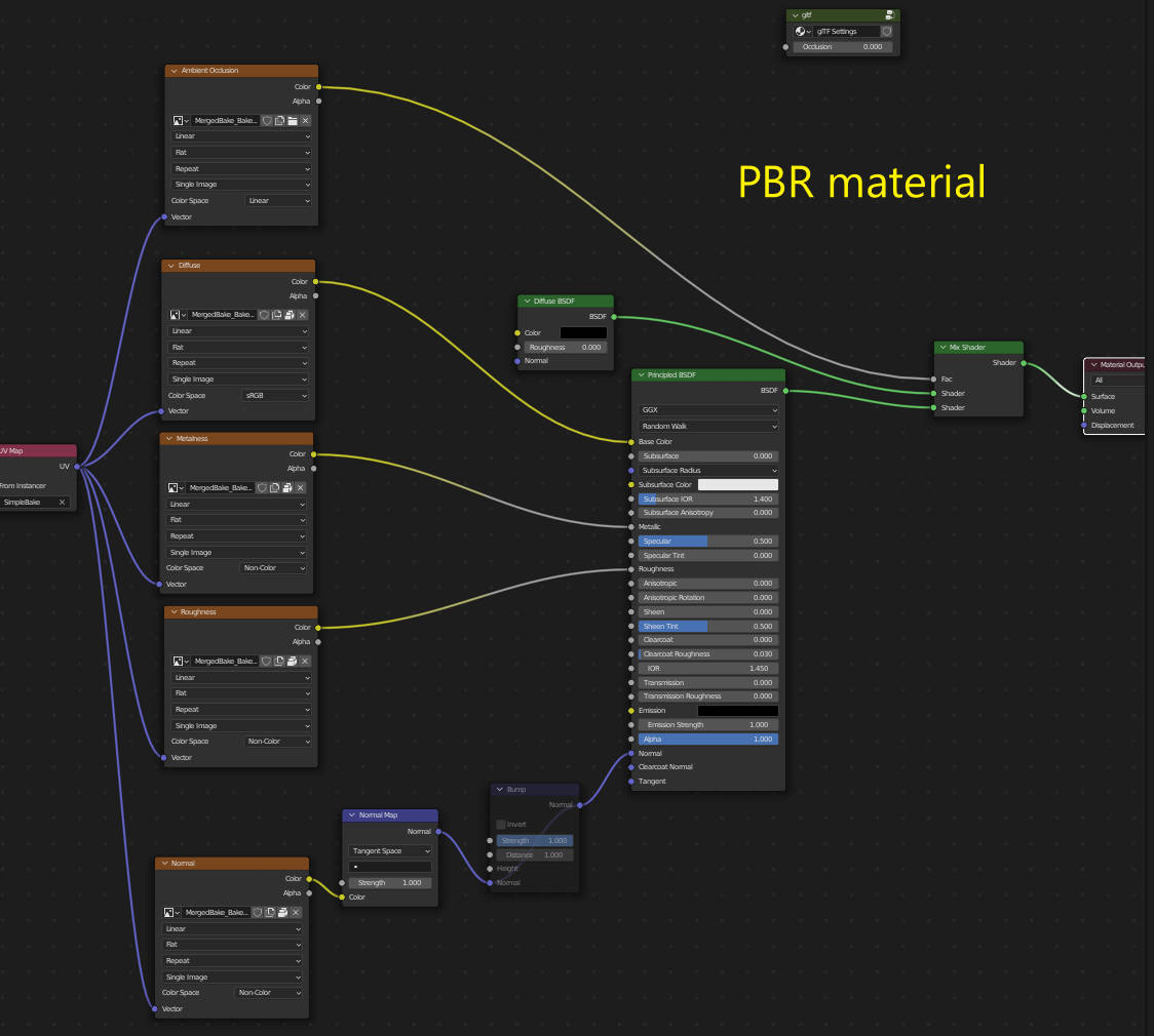

2022-03-21 at 6:26 am #50435hulpesergiu
ParticipantHi x9studio.
I am very confused about your question.
The image on the left looks 90% the same as the one on the right to me.
The only difference between them is some contrast and color correction (the eevee one looks a bit greenish)
I am not sure what you are trying to do.
Also from your material screenshot, I am noticing you are baking the material, maybe you can tell us more details about that?
From the PBR sample project, the results look identical in Verge3D and Eevee. That’s the way it should be for PBR materials. For some reasons my test project is not producing the same result.
It’s simple procedural materials baked into PRB materials using SimpleBake addon.

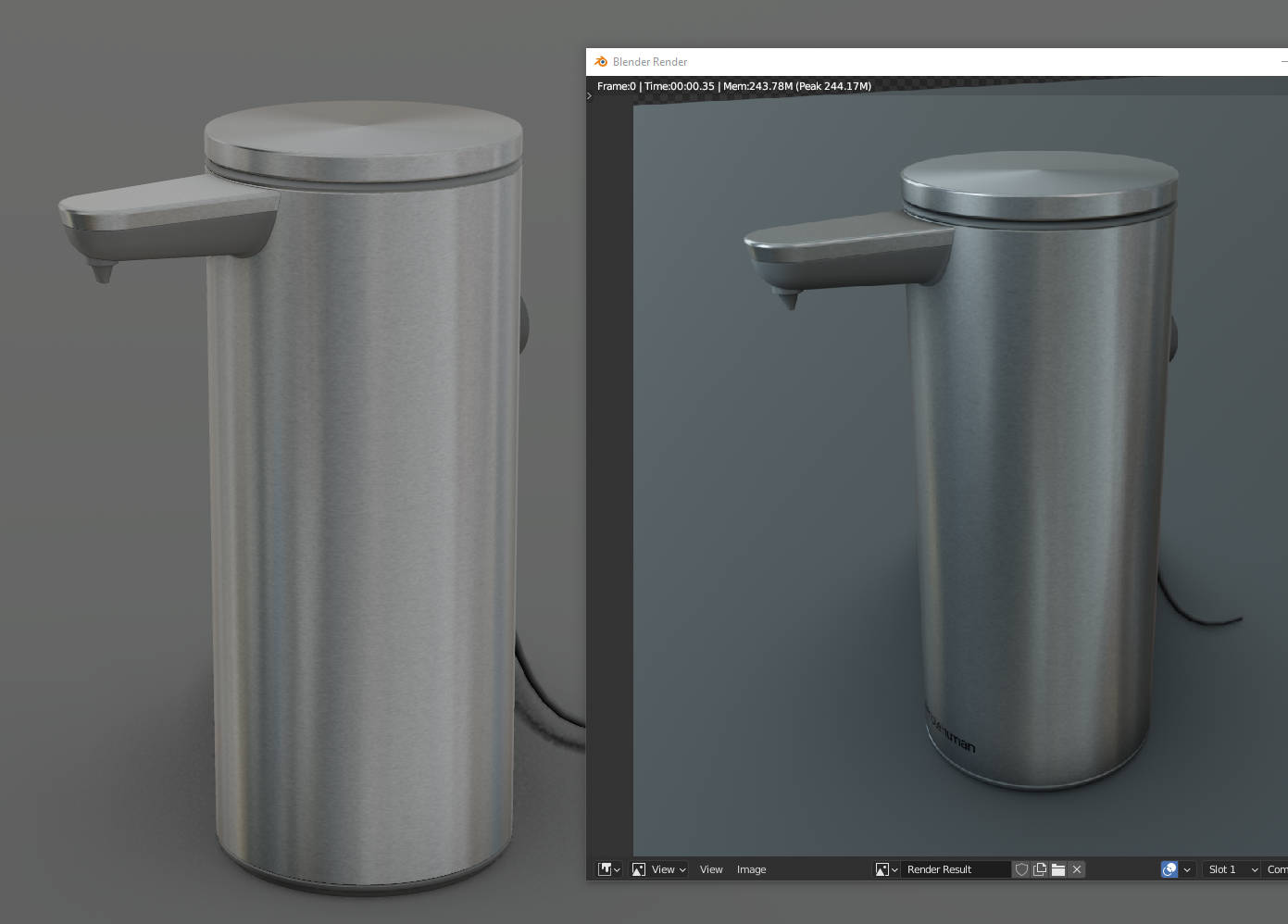

xeonCustomerI personally don’t think EEVEE ever looks close to what you see on Verge3d. Its close but not close enough…. its an iterative process to get the colors right….hope that changes one day…but I have tried on different systems, OS, Verge (blender, max, maya) its always the same…. it’s close…but you still have to tweak and iterate to get it right.
Tutorials - https://www.xeons3dlab.com2022-03-30 at 5:42 pm #50720x9studio
ParticipantAre you using baked PBR textures or Blender native nodes without baking them into PBR textures?
If I can get the result like this, it’s good enough for me.

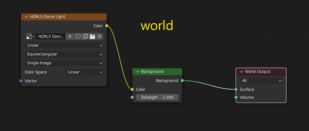

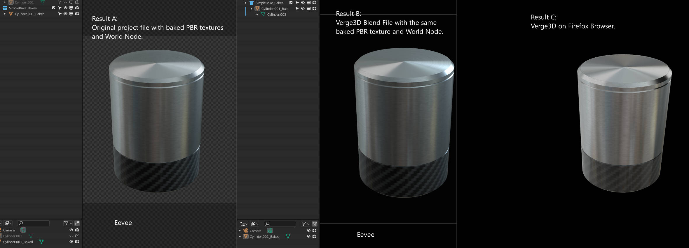

ParticipantI can’t share the Blend file that was posted at the start of this thread. But I’ve created a test project that reproduces similar result where rendered Eevee and Verge3D aren’t quite the same.
My goal is to establish a WYSIWYG workflow. The sample project named Pbr in Verge3D App Manager shows WYSIWYG is possible. But I can’t figure out why I’m not able to produce similar result.
This is my workflow so far:
1. Model, texture and HDR lightmap in a Blend file that I called original project file.
2. Baked PBR textures from the original project file.
3. Create a new Verge3D project.
4. Open Verge3D Blend project from project manager and copy PBR textures and HDR map into Verge3D project folder.
5. Append collection from original project file into Verge3D Blend file and setup materials and HDR map.

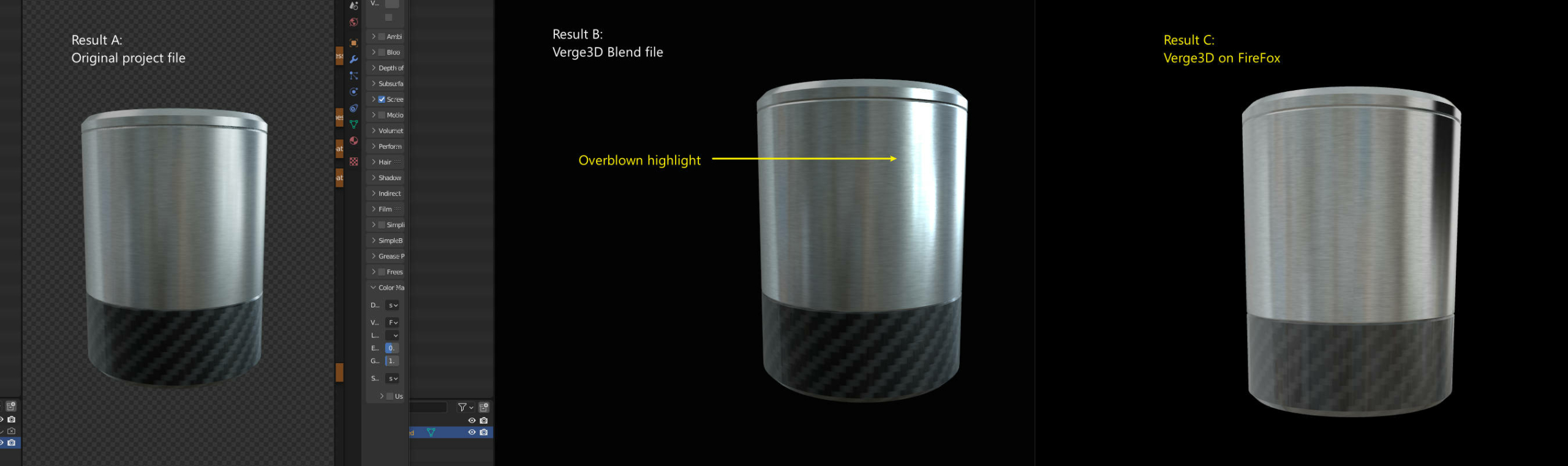

6. Click on Sneak Peek button to see it in Verge3D web browser.At step 5, the result in the original project file and Verge3D Blend file are very similar. But at closer loo, Verge3D Blend file has blown out highlight for some reasons.
At step 6, Verge3D view is quite different from Eevee in Verge3D Blend file.
In the Verge3D Blend file, I use channel packing texture but I had to use sRGB color space in image texture node to get it look similar to original project file.
I can’t figure out what settings am I missing, I’m using Blender 3.1.
Here is the link for Verge3D project folder
https://www.dropbox.com/sh/h66jt2mie6ek36c/AAA5GXzUWtIcrhrpnqvFM2lJa?dl=0Link for original project file https://www.dropbox.com/s/r0dfukwd2j60sd4/Verge3D%20material%20test%20Original%20Project.blend?dl=0
Thanks.
