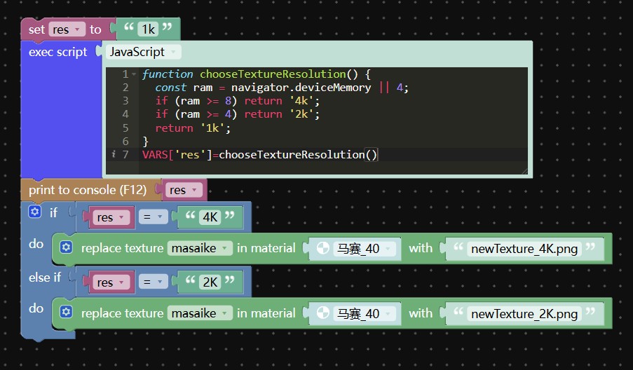

QiangGeParticipant@Nathan, Here is a simple implementation for your reference: it initially uses 1K textures, and then replaces them with higher-resolution textures based on the device conditions.

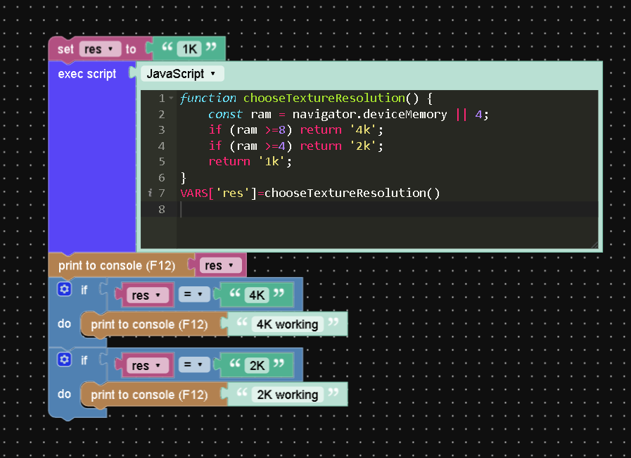

I tried it but it doesn’t seem to work. This is the puzzle and nothing prints in the console.Attachments:
