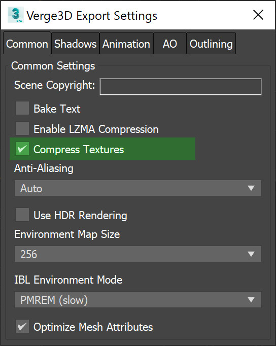

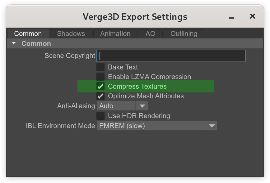

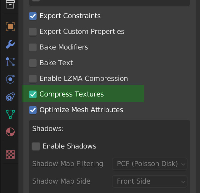

To enable texture compression automatically upon export, you can simply turn on the corresponding option in the export settings.
Compress Textures checker in Blender
Compress Textures checker in 3ds Max
Compress Textures checker in Maya

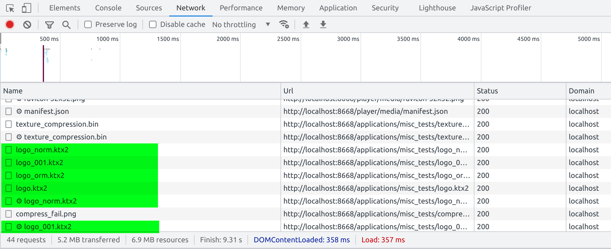

To ensure that your app now actually loads compressed texture, run your app (either from App Manager or from a website where it is deployed). Open the browser console and switch to the Network tab.
Check texture compressing in Chrome console
Reload your app so that the console starts displaying files from the beginning. Find the texture files in the list - if everything is ok, they should end with .ktx2.

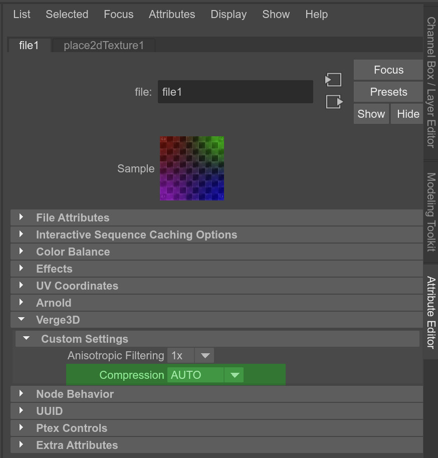

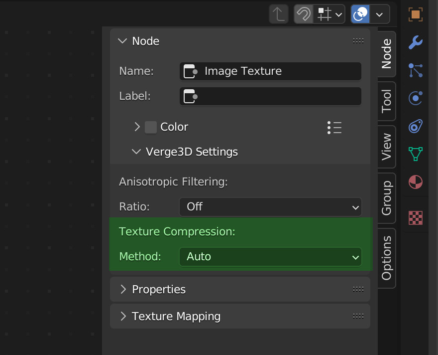

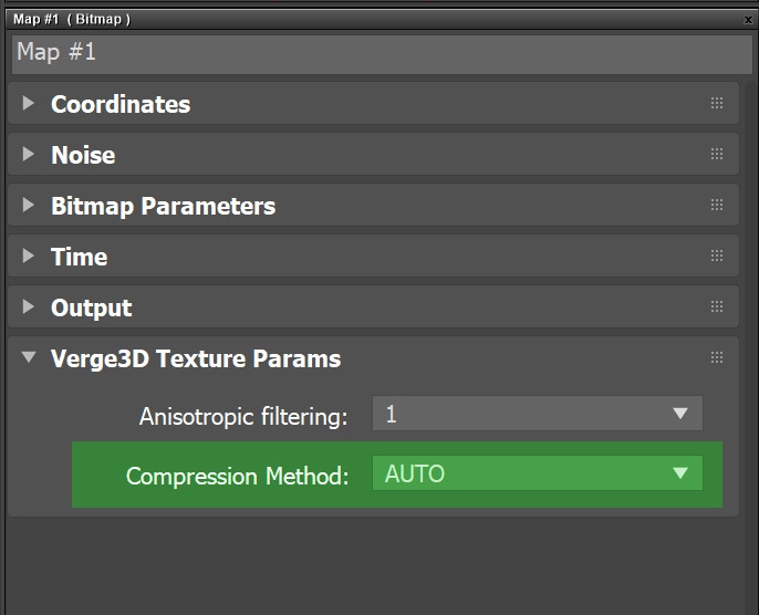

There is an option available for each texture to tweak the compression algorithm:
Texture compression method property in Blender
Texture compression method property in 3ds Max
Texture compression method property in Maya
Auto
Choose best algorithm automatically. Corresponds to using UASTC in the current implementation.
UASTC
Modern method which offers best quality. It is good for everything including normal maps, ORM textures, etc.
ETC1S
Offers best compression and generates smallest files. However, it may cripple textures so you might use it only for non-contrast images (such as grass, wood, bricks, etc).
Disable
Disable texture compression.
