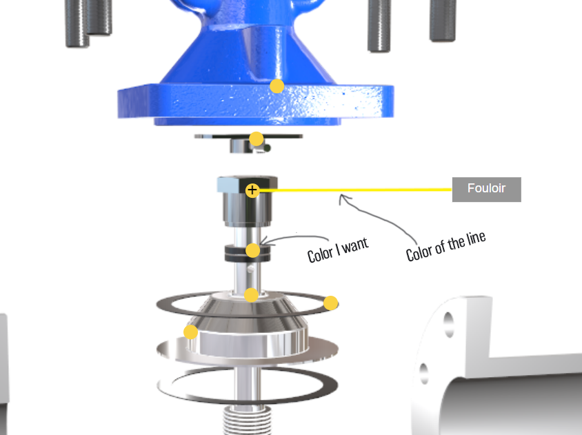

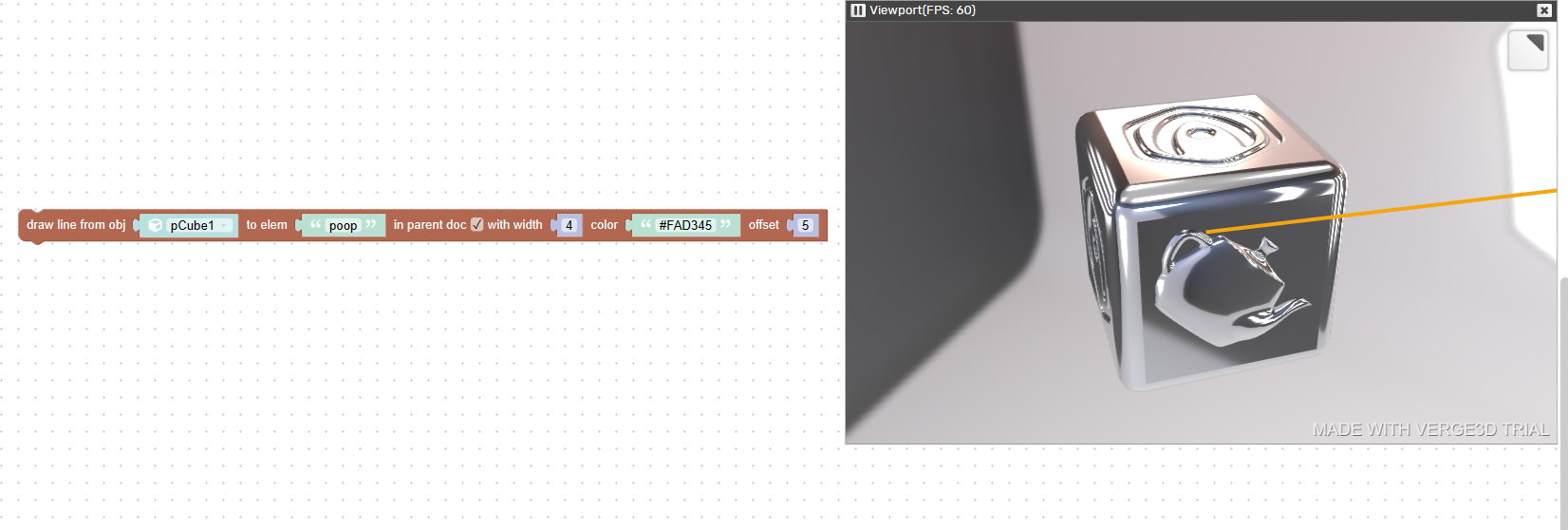

    I’m Alejandro, 3D developper from France, and I’ve been working on a 3D app that allows you to see and interact with a 3D valve. This valve has some annotations and I do some HTML Pop-up windows next to them. I’ve been struggling because I make a line that joins a 3D object with my Pop-up window and it seems like the line does not accept ALL colors, but instead a very specific list of roughly 30 color codes. I need to give the line a very specific line color that is not in the list (#FAD345) and I would like to know which would be the right approach to get that?
    I’ve attached a picture that show the color I want and the color of the line (not the right color).

    Set the color of your annotations close to the color of the line and forget.
    #67735
    alejandro88
    Thanks you a lot for your help!
    The color of my annotations is fixed and I should not change it (project constraints), so I should be able to change the line to this exact color #FAD345.

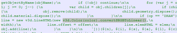

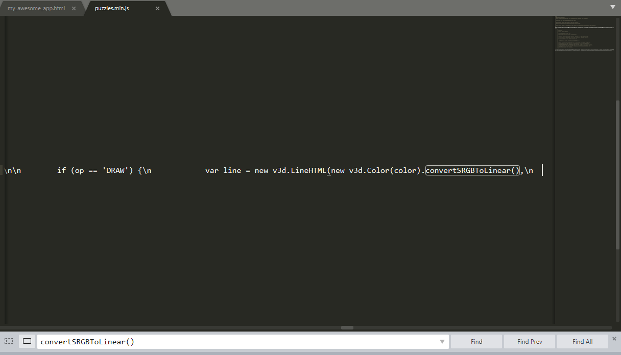

    minified puzzles.min.js and not possible to find the line

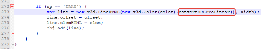

    Open puzzles.min.js in your favorite text editor Notepad++, hit F3. Paste this line into the search field
    v3d.LineHTML(new v3d.Color(color)
    The search result will be only one piece of code.
    Add .convertSRGBToLinear() right after v3d.Color(color). Save. Easy.
    The result should look this way

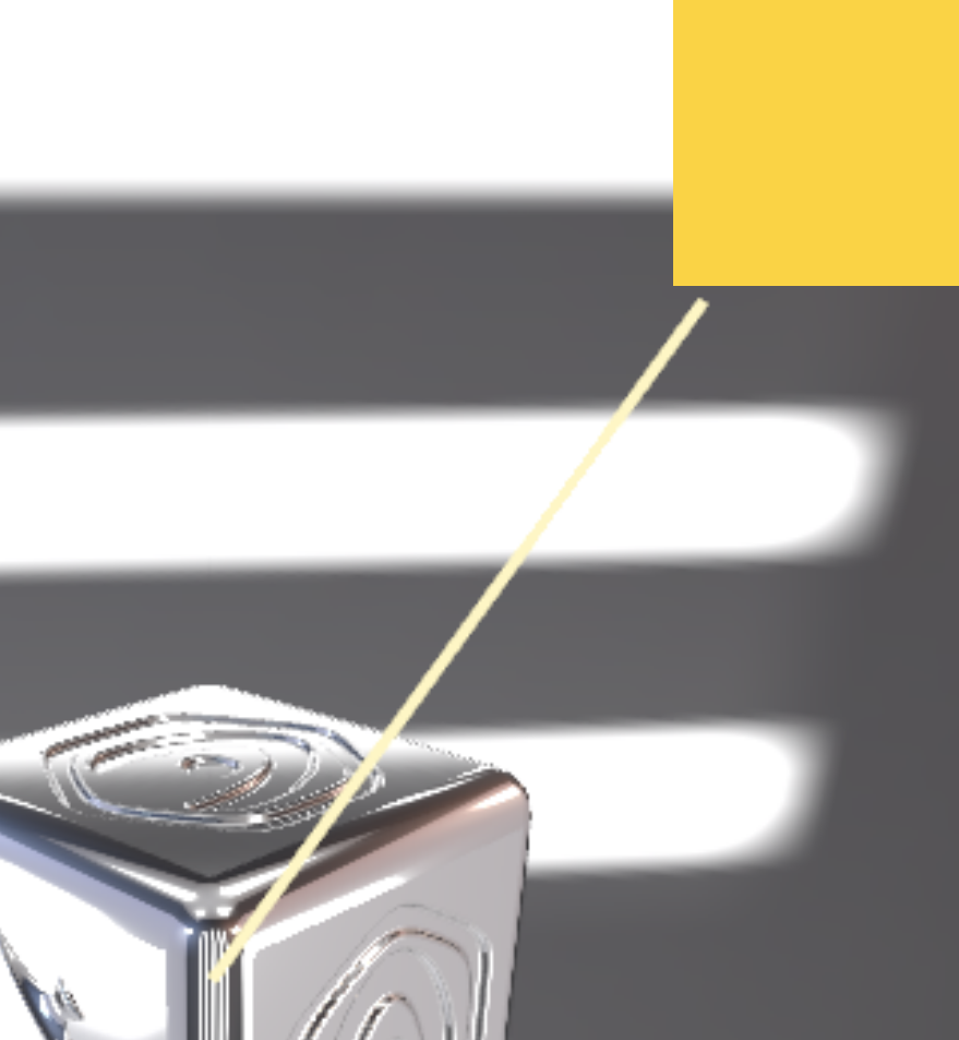

    I tried to do what you did but at first, when I try to add this code and I hit ‘save’, it says that the file cannot be modified, the acces is refused, so I copy pasted the file on my desktop, I edited it and replaced the original. I tried making a line with this color (#FAD345) and a div in the parent document with a background color (#FAD345) and colors don’t match :( but in your exemple, your color is good! I don’t see what I am doing wrong! :unsure:
    Any ideas :D ?
    I attached a picture!
    Thanks again!

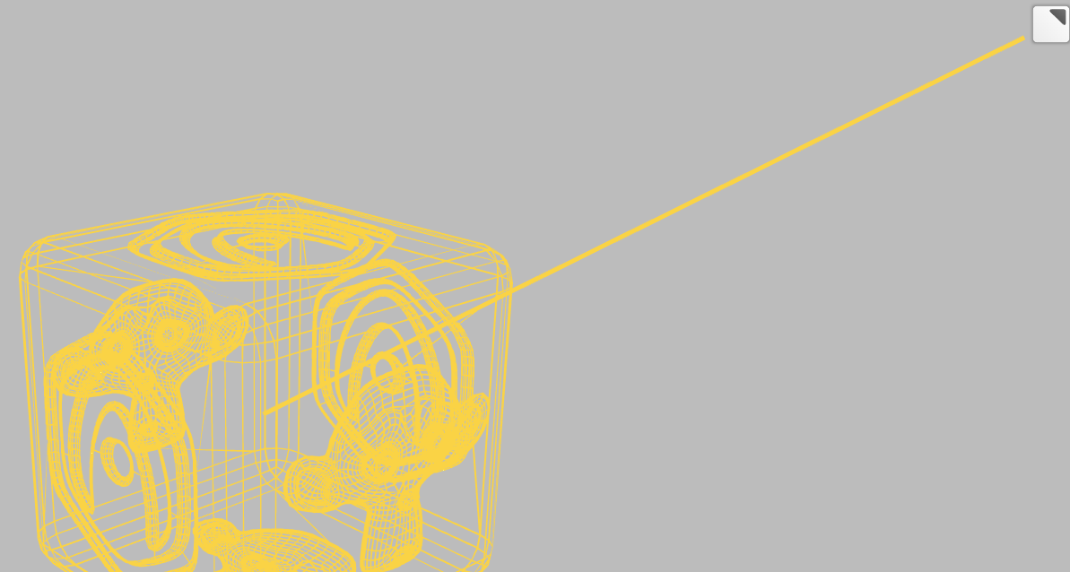

    Looks like for 4.5.0pre2 this fix in puzzles.min.js is not needed. The color is already matching.
    Do you use HDR rendering in you project? In this case the color will be different from the original.

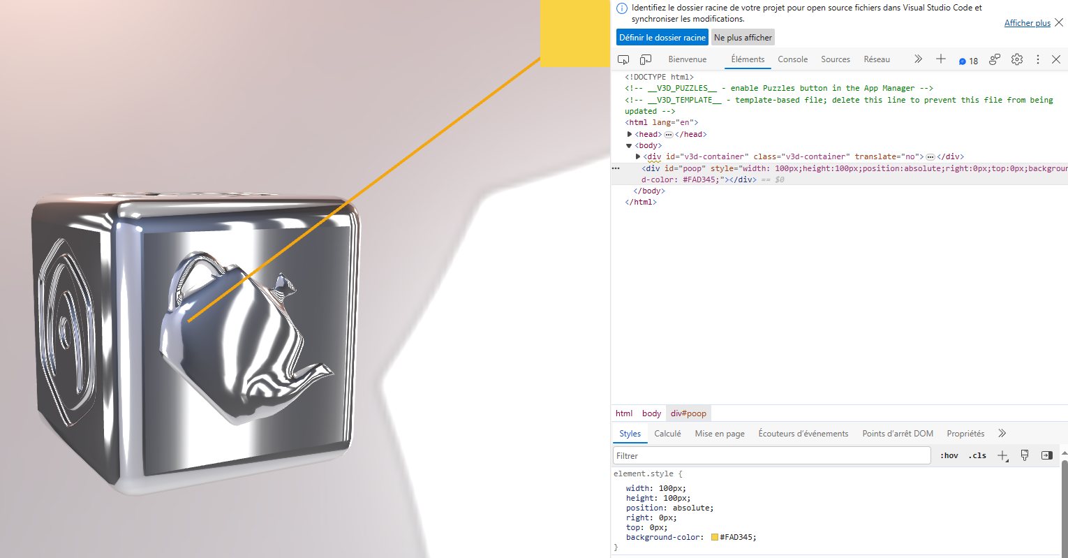

    I downloaded the 4.5.0pre2 version for Maya, and it doesn’t seem to work. The color doesn’t change and I see in your picture, that your line and yellow box match. I tried deleting all the files from the previous version and installing 4.5.0pre2 from scratch. No success.
    I’m not exporting in HDR so it’s even more strange this final line color.
    Which 3D software are you using? I don’t think that the problem comes from that, but it’s the only thing that might be different. ;-) Or is it because i’m using the free version of Verge 3D…?
    Thanks a lot!
