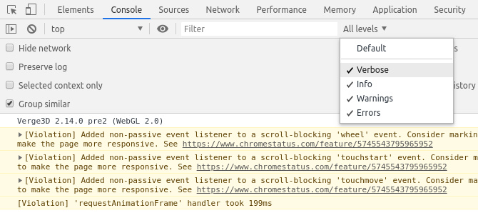

    do we care about this error in chrome console ?
    v3d.js:1 [Violation] Added non-passive event listener to a scroll-blocking ‘wheel’ event. Consider marking event handler as ‘passive’ to make the page more responsive. See https://www.chromestatus.com/feature/5745543795965952
    just wondering if we could ignore it ?
    Cheers,
    Chris

    Can this error be seen in some of Verge3D demos as well?
    3D Verger, the CEO
    #17806
    Yuri KovelenovYuri Kovelenov
    Developer
    I see them now – you must have enabled Verbose level in Chrome console. Nevertheless, I think it is worth looking deeper into those warnings. Thanks for heads up!

    I’m in the middle of trying to optimize performance for animation of geometries etc. And also came across the “non-passive event listener” warning and also “setTimeout handler took <N>ms”.
    Did you already worked on the event listeners optimization?

    these are ‘normal’ warnings which relate to blocking the main thread by 3D rendering.
    Here is some advice on boosting the rendering up
    https://www.soft8soft.com/docs/manual/en/introduction/Optimizing-WebGL-performance.html
