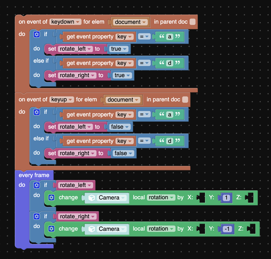

    Hello, this isn’t a tutorial, more a screenshot for an approach that worked for me and I thought may be useful for others. I wanted to make the A and D keys rotate the camera, and this was my solution.
    #52478
    raphroberts
    Here is the scene..
    https://content.une.edu.au/2022/3dp_dinosaur/!dino.html
    (There may be a better way to do this, just sharing in case it helps anyone)

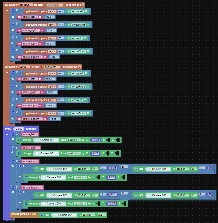

    #60935
    rebuhleiv
    Awesome. For me the camera jumped when using “every frame do”; I also had problems when rotating top/bottom wards.
    These problems are solved here if somebody is interested:
