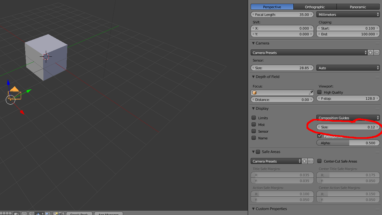

    I now have a giant camera,
    Its better to use Size in camera settings to reduce size of the camera.
