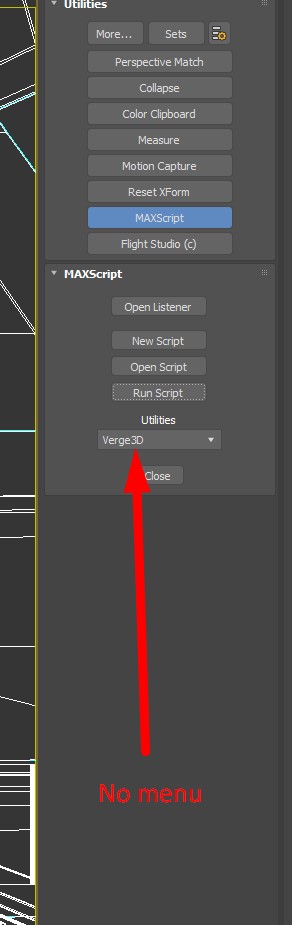

    Hello, I do face the typical error when trying to render on a farm.
    There is no scropt available on the utilities to cleanup the scene, verge 3d is visible but no parameters to clean up the scene.
    So what’s should I do to render my scene? Thanks

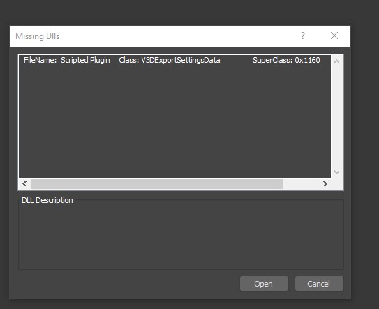

    1/31/2023 20:44:30 PM; Initializing Python version: 3.7.9
    1/31/2023 20:44:59 PM; ***WARNING*** Missing dll: Scripted Plugin – V3DExportSettingsData
    1/31/2023 20:45:00 PM; ***WARNING*** Missing dll: Scripted Plugin – V3DExportSettingsData

    After removing the verge3d path into max system path, I still get the same error witht he farm:
    2/1/2023 8:49:33 AM; Initializing Python version: 3.7.9
    2/1/2023 8:49:57 AM; ***WARNING*** Missing dll: Scripted Plugin – V3DExportSettingsDa
    So please, how can we render our job?
    #60067
    fraggle
    Finally get ride of it, but a pop up missing plug in keep asking for verge so we can’t batch the submission, we have to do it manually.

    fraggle
    Unfortunatly I can’t submit to the farm without opening the scene.
    I also notice that all xref are lost after deleting the verge3d path and I can’t load them again because when I open the scene I have to choose cancel and not open when the scene is asking for the plug.
    So I’m going to add again verge3d path, then merge all xref, then delete the verge3d path again, then hope it works.

    fraggle
    OK, the xref was the one causing problem. I merge them into the scene and I don’t get the message anymore when opening the scene.
    But all the asset create while verge3d was installed are “infected” with verge3d (please note auto assigned verge is not check but this recent experience proove that it doesn’t help) .
    How can we get ride of verge3d once for all on all asset without opening all of them one by one?
